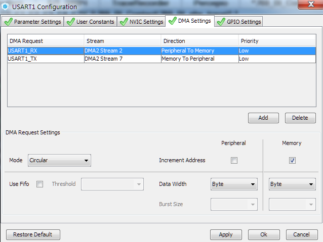

HAL drivers currently don't support circular receive data over DMA?
