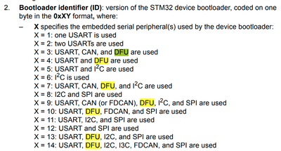

We use a couple of different STM32's in our products and update them over USB via built-in the DFU bootloader.
I noticed that:
Is there any significance to this difference or is that just differences in the bootloaders between the 2 models?
Thanks,
Mark
2023-09-26 6:56 AM
Should function the same. There are a lot of "different" system bootloaders to support all the various chips.
2023-09-26 12:52 PM
I agree they "should" function the same, but I am seeing different behavior with the two parts I mentioned when "leaving" DFU mode.
Just exploring obvious differences.
