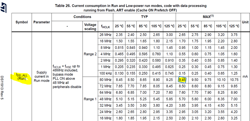

what is the difference between these below currents
– 84 μA/MHz run mode vs Run mode current of 9.45mA in the below table
I always confused which current i have to consider while doing power calculations.
like uA/MHZ when to consider and with out indicating clock only showing mA current consumption.

"what is the difference between these below currents"
That's given in the titles of the tables:
"like uA/MHZ when to consider and with out indicating clock only showing mA current consumption"
Current consumption of the chip itself will always depend on how fast it's running - the faster it runs, the more current it takes.

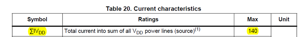

The current that a pin can source/sink is a fixed limit - it doesn't depend on speed.

And at 80 MHz the current consumption with while(1) is 99 uA/MHz, which makes 7,92 mA in total. The rest can be consumed by many things, including the debug interface. It's described as issue 3a here:

@na.1 "what exactly Run mode current represents"
Exactly what it says in the title of that Table!
There should be separate documentation of what the on-chip peripherals consume.
