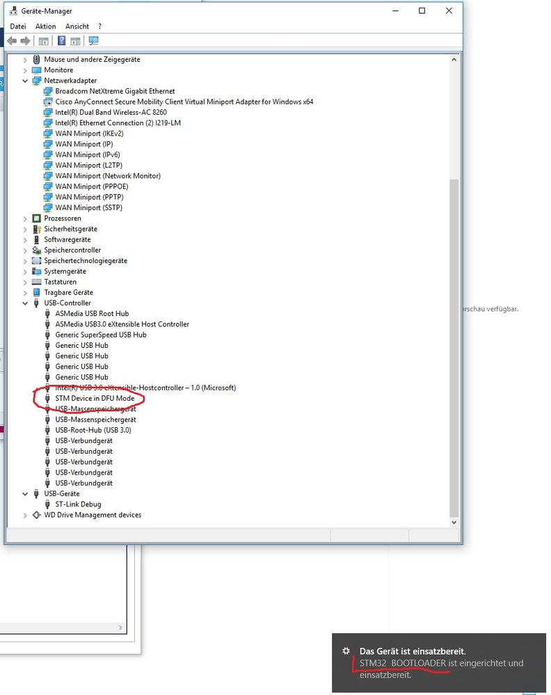

That is anoying. STM32CubeProgrammer does not work in DFU mode and Its probably a driver problem. On Page 7/39 in UM2237 STM32CubeProgrammer software description - DFU Driver. There it is described to uninstall the old 'STM32 DFU Device driver' for DfuSe. Which i Did by deleting the driver in Windows Hardware Manager by right click - deinstall - delete all driver files.
Then as descibed i ran the “STM32 Bootloader.bat� file as admin.
After that reconnected STM32 (any nucleo board) in DFU Mode but still the old 'STM Device in DFU Mode' like in Figure 1 on page 7/39 gots installed and not the STM32_Programmer Driver driver like in Figure 2 page 7/39
Therefore STM32Cube Programmer does not connect to any uController in DFU mode

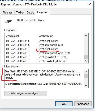

After updating all possible drivers on my laptop still no success.
After deleting driver as mentioned in App Note and klicking the bat file, when new plugged in in DFU Mode Windows 10 installs the drivers as ''STM32 BOOTLOADER'' but list it as old ''STM Device DFU Mode'' in Device Manager
Also when Rightklick in Device Manager on ''STM Device in DFU Mode'' in Properties it says:
The Device ''USB ..... '' was not migrated because of partly or ambivalent analogy .
