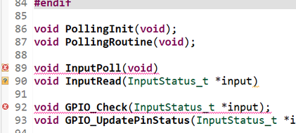

What error? Added what file? Explain in more detail.
If you're talking about the latest project you've uploaded, did you even look at my main.h file?
extern and #include are needed just like i have in my main.h which you need to add to your main.h

I added this to my previous file. I forgot to add it to the project I created from scratch called test3.
Bu dosyayı benimkine ekledim ve hala hata veriyor.
when you added the prototypes, you didn't add the semi colon

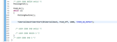

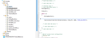

PA10_off does not work after 1sec. PA10 "1" is always
It should be "0" after 1sec but timercallback does not work.
Can you try it on your own board? It definitely doesn't work.
I have been trying to make a 500 ms delay since the first message I opened in the topic.
Unfortunately, I couldn't take any steps forward. It always blocked the mcu and timers.
TimerCallbackTimerStart(&timerCallback, PA10_Off, 500, TIMER_NO_REPEAT);
I was very hopeful about the function above.
It's because you keep calling it in a while loop. Each time you call it, it resets the callback timer.
Look at my signature and watch the video
