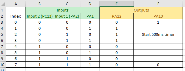

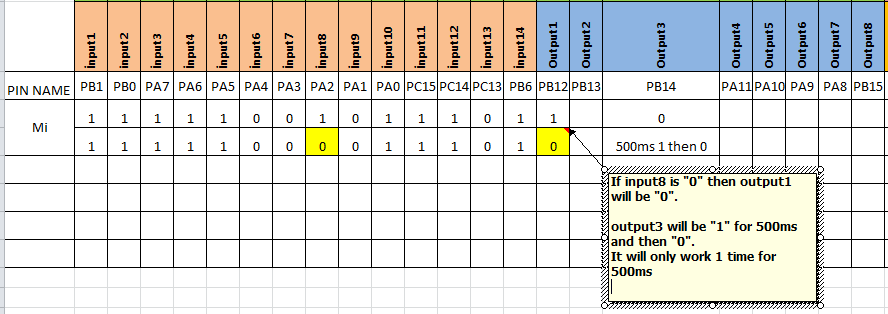

When Pin_A2 is "0", Pin A10 becomes "1".
Continuing..
If Pin_A2 becomes "1", Pin A10 becomes "0" after 500ms.
That is, it works in reverse.
There is no delay when the input comes
It waits for 500ms when the input disappears.
Note1 : I am writing with Translate, I hope I can explain.
Note2:
The program is currently running as follows.
When C13=1 and A2=1, A10=0
When C13=0 and A2 =0, A10 =1
500ms after C13=0 and A2 =1, A10 =0
It drops to 0 not when the input arrives, but after the input disappears.
Continuing..
Note2:
You need a truth table. So far from the code you've posted and your last post, I've made this table. There are some unknowns of what PA10 state is, so I left those blank.
You need to fill in the blanks so we really know what you're trying to accomplish with all the outputs based on all the input states.
