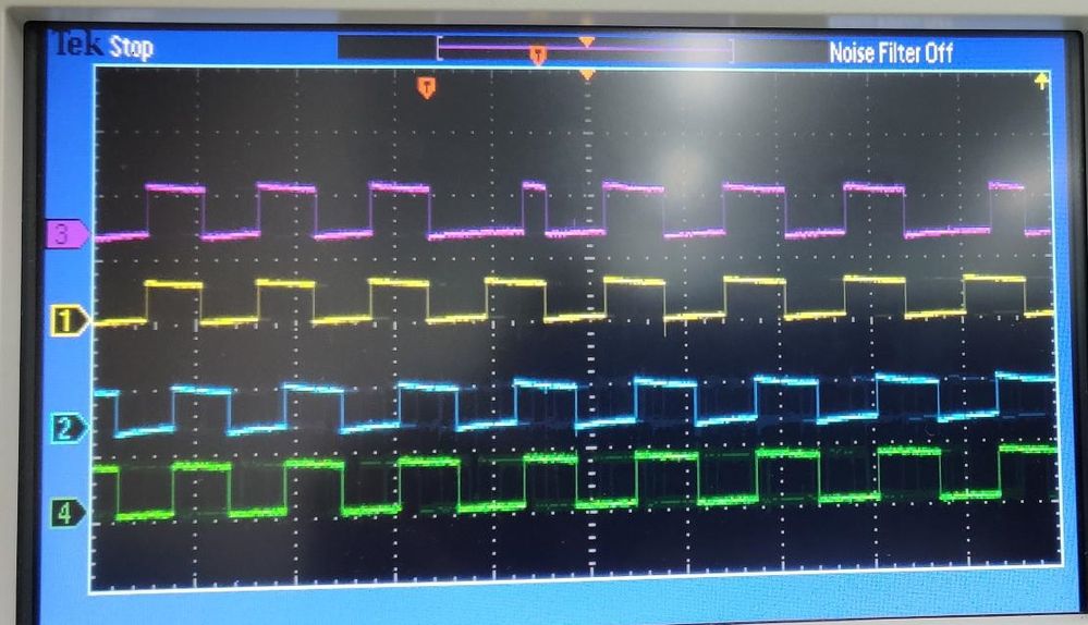

The oscilloscope trace is as follows:
Now here the the channel 3 is supposed to follow channel 1 and Channel 4 is supposed to follow channel 2... but as you can see there is an instance in channel 3 where there is a considerable delay (right around the middle) which is almost 60us... this is a random behavior and the delay values also vary. this ideally shouldn't happen.. even worse case issue is when the delay exceeds the next edge change, in which case i can totally miss an edge.
i am using this to calculate the number of edges so this is causing a lot of issues.
Can anyone throw some support on this to identify the reason for delay in processing the GPIO interrupts.

Updated the original post with the Interrupt code and the MSO plot.
also we have made the GPIO as the highest priority. there are 2 other interrupt (SPI and timer) but they have priority as 2 compared to 0 for GPIO.
