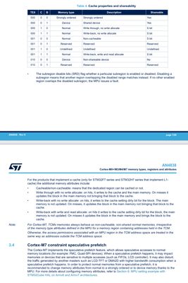

Thank you for the interesting question , indeed STM32H7 contains Cortex-M7 core which has a native L1 Cache and this core is designed before Cortex-M33 which is an extension for M4 with TZ - so not the same architecture and not same usage of MPU attributes versus security. M7 is focused on High performance throughput and so delivering much power thru the MCU architecture while dealing with L1 Cache . A very important MPU setting and warning with some memories are the M7 speculation feature as described here , Section 3.4

I understand the usage variability depending on particular applications (especially the need to configure DMA is very application-dependent), but if there are requirements for MPU configuration to use all of the onboard memory and peripherals, those should be well documented. What I'm suggesting is a starting point or template to get most users up and running, and from there make a few adjustments or add some new regions to manage DMA or other requirements. In fact restricting DMA is just 1 of many possibilities with the MPU configuration. What about Shareability, Transient, Allocate, and MPU Device settings? These options exist but when should/shouldn't they be used with respect to the onboard memory map? How do we know the proper settings for onboard memories and peripherals?
