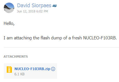

I am attaching the flash dump of a fresh NUCLEO-F103RB.
________________ Attachments : NUCLEO-F103RB.zip : https://st--c.eu10.content.force.com/sfc/dist/version/download/?oid=00Db0000000YtG6&ids=0680X000006HxVc&d=%2Fa%2F0X0000000az4%2FSeyIL01GtcMYF5L28JZTKXxDNZIpMg5FdPrwDj.AJ8g&asPdf=false2018-06-12 9:48 AM

2018-06-13 3:44 AM
David,
perhaps I have tomatoes on my eyes, but I can not see your attachment!
Can you point me to the image or attach again?
Thanks
2018-06-13 3:57 AM
Hi Uwe,
hmm... should appear just below the message:
This is the direct link:
https://community.st.com/servlet/JiveServlet/download/201675-1-12552/NUCLEO-F103RB.zip
(also re-attaching it here). ________________ Attachments : NUCLEO-F103RB.zip : https://st--c.eu10.content.force.com/sfc/dist/version/download/?oid=00Db0000000YtG6&ids=0680X000006HxVw&d=%2Fa%2F0X0000000azB%2FaUzzURrk0JEozZ.6TWYlatwgxBmfepSlD53luzwoNYQ&asPdf=falseWe’re moving the ST Community to a new platform to give you a better and more reliable community experience.
