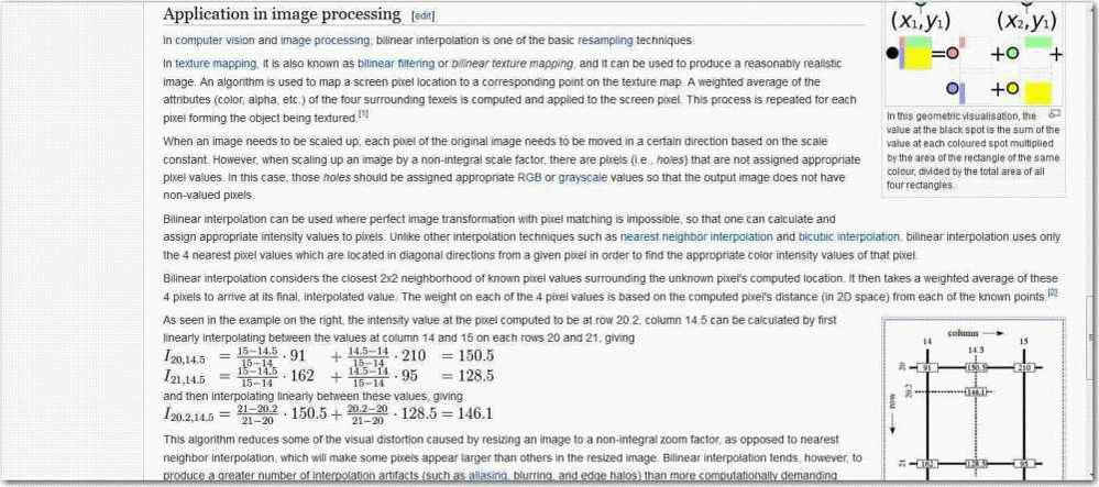

So if I follow :
http://upload.wikimedia.org/wikipedia/commons/thumb/a/a7/Bilin3.png/220px-Bilin3.png from http://en.wikipedia.org/wiki/Bilinear_interpolation#Application_in_image_processing I will shring the picture by half ? for example 1024 x 768 becoming 512 x 384 ?2014-04-20 10:28 PM

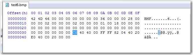

I have test6.bmp which is 2x2 pixel 24 bits:
2014-04-21 5:17 PM
Am I on the right calculation and way of thinking ?
thanks2014-04-21 5:30 PM
Does it always begin from offset 0x3E on the file no matter the resolution of the picture ?
It's the same for 1bit,8bits,16bits and 24bits picture ? I can see from every pictures, it's started from 0x36, reference :Start of pixel array (bitmap data)
36h 3
00 00 FF 0 0 255 Red, Pixel (0,1)
http://en.wikipedia.org/wiki/BMP_file_format#Bitmap_file_header

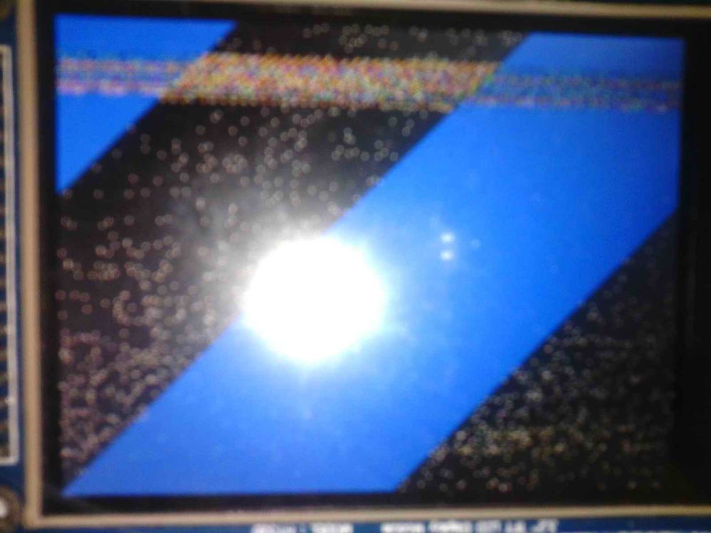

delay_ms(2000); for displaying :
http://iphotobucket.com/albums/p231/picture_77/test32_zpsa24eb6e1.png
but it's displaying :http://iphotobucket.com/albums/p231/picture_77/IMG_20140427_095513_zpsd8864b8e.jpg
Does anyone have a clue ? thanks2014-04-27 9:40 AM

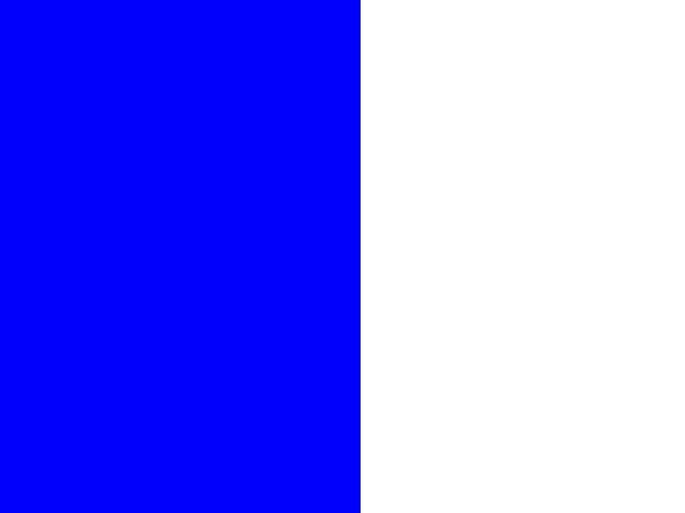

} I want to convert 1024*768 :
The result I got from that function :http://iphotobucket.com/albums/p231/picture_77/IMG_20140427_095513_zpsd8864b8e.jpg
Do you have idea where I miss here ? thanks2014-04-28 4:06 AM

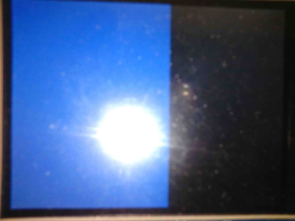

2014-04-28 5:38 AM
It does the task but why can't I see the white color ? suppose to be blue and white,
