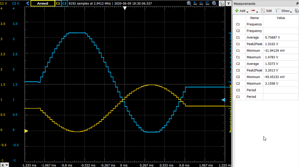

I found something quite strange, it seems that:
1) On DAC Channel 1 - the output buffer does not work (a 10kOhm load brings the voltage down), but it's output is inverted (as expected)
2) On DAC Channel 2 - the output buffer does work (maintains voltage with a 10kOhm load), but it's output is not inverted
My test setup:
The results:

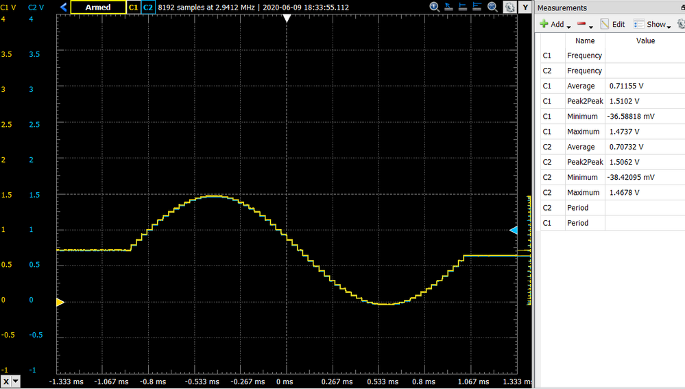

With Output buffer OFF on both channels, the sine wave is not inverted, and the voltage is sinked to max 1.5V - this is as expected.
With the output buffer ON on both channels, you can see that Channel 1 (yellow) is inverted but its output is still sinked, and that Channel 2 (blue) is not inverted but its output is maintained with the load.
Note 1: I desoldered the SB21 to disconnect the LED 2 from the output of the Channel 2 - but even before I did the results were almost the same (it just added a load and a small cut at the top of the waveform).
Note 2: I also double checked the value of the DAC->CR register with the debugger, it shows:
I went through the datasheet but it does not say anything about differences between the DAC's. I guess I am doing something wrong somewhere?
Thank you!! :D

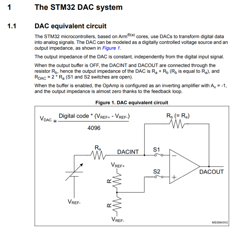

And yes I would expect the buffer to invert the output, since it is configured as an inverting opamp with G=-1 ?
See from https://www.st.com/resource/en/application_note/dm00129215-extending-the-dac-performance-of-stm32-microcontrollers-stmicroelectronics.pdf @page 5:
