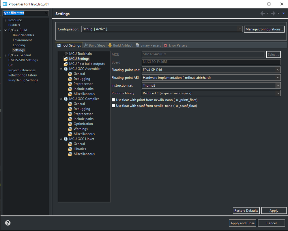

I find the 170ns for 4 Multiplications pretty long. However, it is with float variables. Can anybody comment on this? Do I have to activate the FPU somewhere in the Project?
In the project properties, you can find
Thanks in advance for your help!

It looks like the FPU is active.
170 ns is not too bad, that's about 30 clock cycles at 180 MHz.
