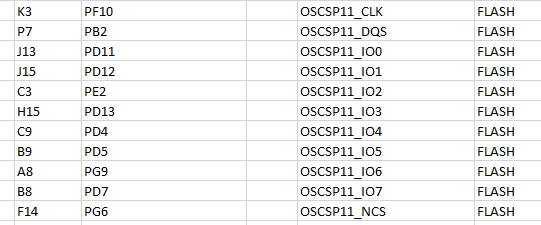

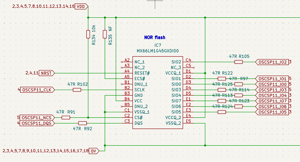

You used the same pins as the H735G-DK, or some other combination?

24-BALL BGA (5x5 ball array) on custom board

I believe I have managed to create a new external loader (using the IAR IDE) based on the MX25LM51245G loader code (from https://github.com/STMicroelectronics/stm32-external-loader) and have changed the Dev_inf file to reflect the change in memory size to the MX66LM1G45G flash. Looking at the datasheets for both chips they look virtually identical on commands and timings. I still dont appear to be able to either reliably communicate with the MX66LM1G45G chip and can't reliably erase, read or program. Any guidance as to what parameters I should be changing?
