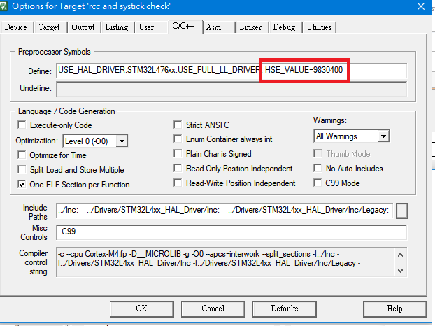

I think I found why this would happen.....
using HAL library, here my Crystal is 9.8304MHz
in file stm32l4xx_hal_conf.h , you can find this macro
#if !defined (HSE_VALUE)
#define HSE_VALUE ((uint32_t)
9830400U
) /*!< Value of the External oscillator in Hz */
#endif /* HSE_VALUE */
Once you choose LL drivers, the project includesstm32l4xx_ll_rcc.h
Unfortunately, the macros in stm32l4xx_ll_rcc.his still as followed:
#define HSE_VALUE 8000000U /*!< Value of the HSE oscillator in Hz */
If you manually modify this value to your crystal's frequency,
If you define the HSE_VALUE in the project setting (thanks
meyer.frank
‌ for reminding this!)
for example, in keil,
Everything would work as you expected!
Guess we need ST guys to fixed up the library.

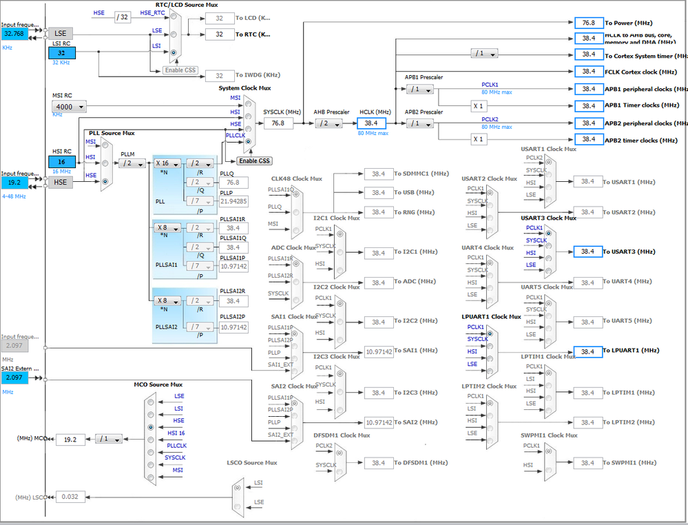

19.2MHz to be exact. As I stated, I programmed the timer2 to run at 1ms interval with no problem so the timing for APB1 at 38.4MHz based on the 19.2MHz external crystal should be correct.
htim2.Instance = TIM2;
htim2.Init.Prescaler = 383;
htim2.Init.CounterMode = TIM_COUNTERMODE_UP;
htim2.Init.Period = 99;
Besides, SysTick should run at 1ms no matter what, am I right?

Suppose your HCLK is really 38.4MHz,
Check your Systick register:
see whether SysTick->LOAD == 38400 -1 ???
e d
Associate II
Posted on June 08, 2017 at 17:09
I traced to this line and for some reason it says:
SysTick->LOAD  = (uint32_t)(ticks - 1UL);
where ticks is 16000.... Where does this 16000 come from when I specified clearly the clock settings as seen in the CubeMX image? Is it possible that I have 2 clocks running because my timer2 is definitely derived out of the 38.4MHz HCLK. The SysTick seems to run out of the 16MHz internal clock. This would be extremely undesirable and CubeMX should resolve it somehow.
I am using the STM32L486VGT chipset. Thanks!

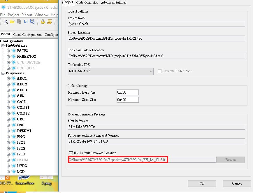

Posted on June 08, 2017 at 17:56
Check your FW package version, is it 1.8.0 ?!
e d
Associate II
Posted on June 08, 2017 at 18:11
How do I check this?
Posted on June 08, 2017 at 18:20
In CubeMX, Project->Settings, you will see
if it's not the latest, go to Help->Install New Libraies, and download the latest one!
