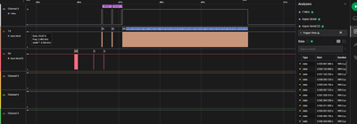

Here is a screen shot what Retriggerable pulse looks like.
Channel 0 is Retriggerable timer pulse
So it is working quite well but not happy with how stm implemented this simple functionality with such a complication.

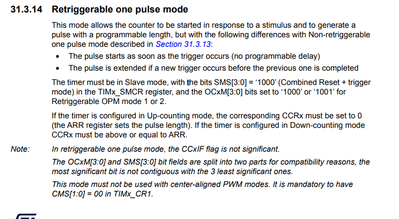

So according to datasheet it is said that the timer needs to be in combined reset + trigger mode .

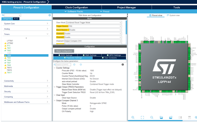

So in cubemx i selected following options
in case of my initialization code i changed the period value to 1ms pulse

Describe, what do we see on that captured waveform, and how is it different from the expectations.

ignore the first pulse as it is just from reset and some noise
as you can see from pulse in red circle. i invoked the timer trigger once but after that i could not trigger it and timing was also not what I set.
