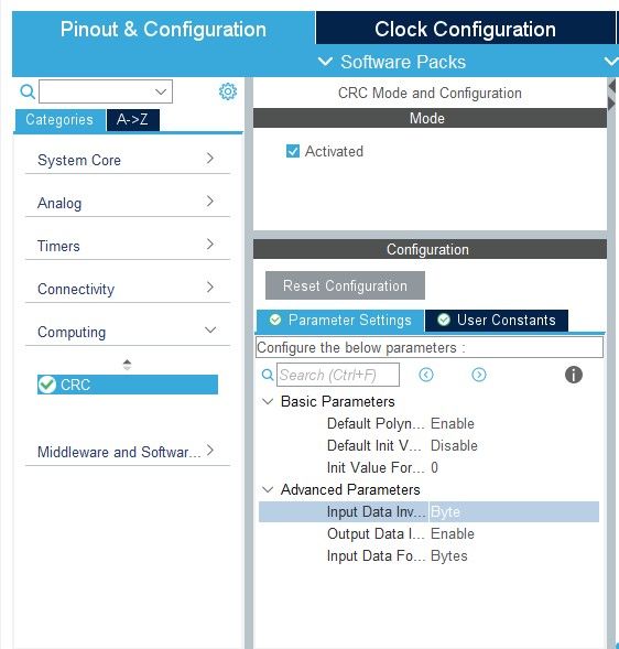

In the CubeMX I have already activated the CRC スクリーンショット 2023-10-23 113347.jpg
and in stm21f0xx_hal_conf.h  file the  #define HAL_CRC_MODULE_ENABLED is already uncommented.
