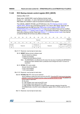

It turns out that the ultra convoluted ST code does a reset, in HAL_RCCEx_PeriphCLKConfig() but it does it only when certain bits in BDCR are unchanged. Does anyone know why?

		/* Reset the Backup domain only if the RTC Clock source selection is modified from reset value */
		tmpreg1 = (RCC->BDCR & RCC_BDCR_RTCSEL);
		if((tmpreg1 != 0x00000000U) && ((tmpreg1) != (PeriphClkInit->RTCClockSelection & RCC_BDCR_RTCSEL)))
			/* Store the content of BDCR register before the reset of Backup Domain */
			tmpreg1 = (RCC->BDCR & ~(RCC_BDCR_RTCSEL));
			/* RTC Clock selection can be changed only if the Backup Domain is reset */
			__HAL_RCC_BACKUPRESET_FORCE();
			__HAL_RCC_BACKUPRESET_RELEASE();
			/* Restore the Content of BDCR register */
			RCC->BDCR = tmpreg1;
			/* Wait for LSE reactivation if LSE was enable prior to Backup Domain reset */
			if(HAL_IS_BIT_SET(RCC->BDCR, RCC_BDCR_LSEON))
				/* Get tick */
				tickstart = HAL_GetTick();
				/* Wait till LSE is ready */
				while(__HAL_RCC_GET_FLAG(RCC_FLAG_LSERDY) == RESET)
					if((HAL_GetTick() - tickstart ) > RCC_LSE_TIMEOUT_VALUE)
						return HAL_TIMEOUT;
		__HAL_RCC_RTC_CONFIG(PeriphClkInit->RTCClockSelection);
The comment says it: it resets the backup domain only if it is not in reset state and you want to change the RTC clock source. The reason has nothing to do with the VBAT-domain brownout-induced corruption/erratum, it's relatively new after all ; Cube/HAL does it because of:
