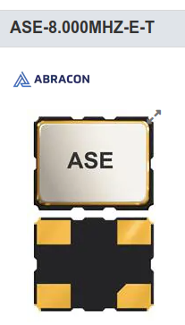

2023-12-29 12:20 PM
HSE available only as external clock input ->
use an oscillator (crystal+driver in a case), today not much more expensive than a crystal, see:
https://www.mouser.de/ProductDetail/ABRACON/ASE-8.000MHZ-E-T?qs=s46Hw6dZPL50VkqizsE0GA%3D%3D

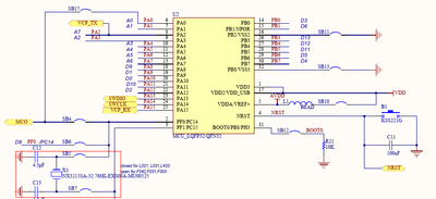

Regarding Nucleo boards: What I really want to learn is PCB design of microcontroller products, not just software or firmware programming. I actually have three Nucleo boards (but none with the STM32L010 family) and a bunch of boards (Blue Pills?) with STM32F processors. Are you saying that the schematics for a STM32L010 family Nucleo or discovery board are available, and I can just copy from them? If so, can you provide a link?
Thanks, again, for your advice.
-Kevin
2023-12-29 12:52 PM - edited 2023-12-29 12:53 PM
hmmm...
https://www.st.com/en/evaluation-tools/nucleo-l011k4.html
from cad ...
https://www.st.com/resource/en/schematic_pack/nucleo-32pins_sch.zip
