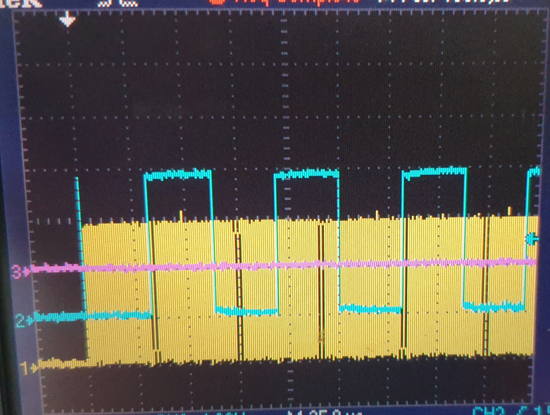

299 = 598If I connect the WS of the slave transmitter to High (3V3)
I receive these data:
0 = 0
1 = 0
298 = 0

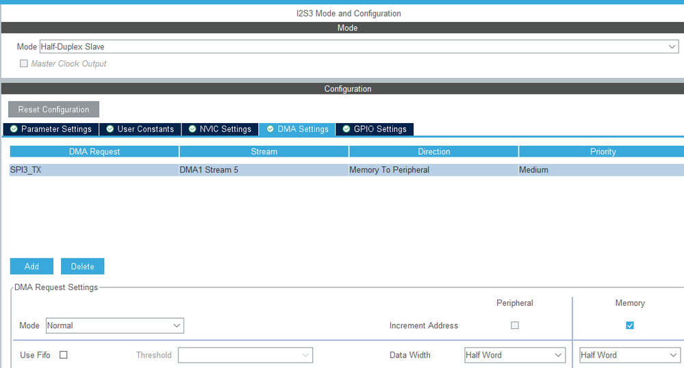

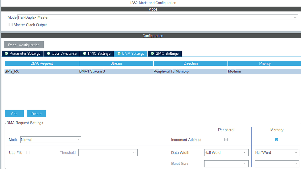

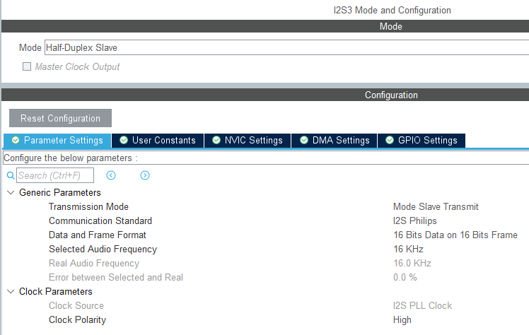

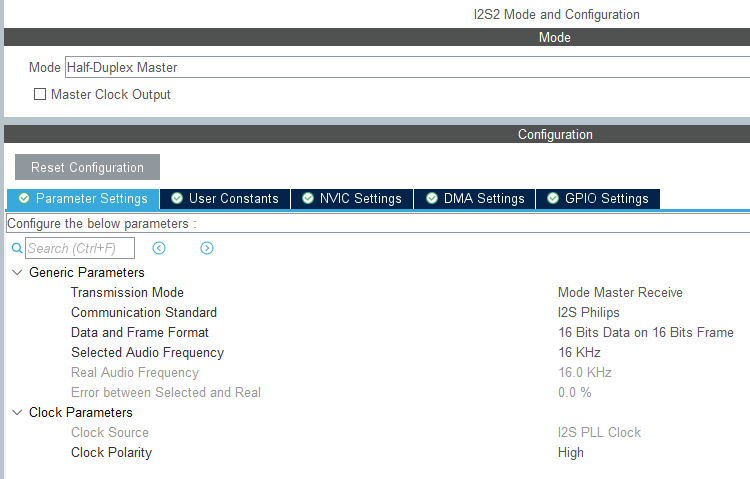

Master RX Parameter setting and DMA
Slave TX Parameter setting and DMA

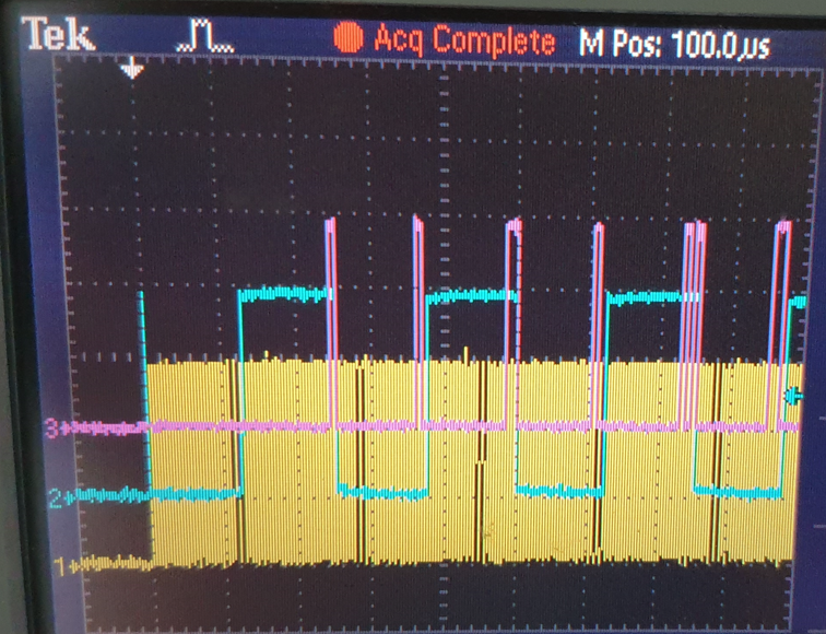

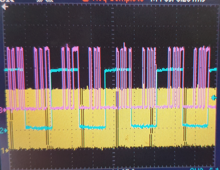

Waveforms:
Similar to Q1 above. When connected normally all is ok. But when WS of Slave TX is connected to GND, still the same waveform, I expect only Left or Right to be transmitted.
The data shown is the beginning of the data, where SD pin is transmitting 0 - 6.
CH1 Yellow = CK
CH2 Blue = WS
CH3 Pink = SD

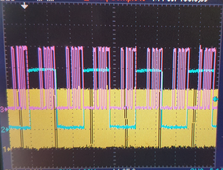

Similar to Q2-3 above. I2S is still sending data even after the last data (299), the data being transmitted is always 299 0x012B.
Before the last data is sent (299), the data is still incrementing to 299. The last 2 data are not 299 and same.
Similar to Q5 above. WS pin on the Slave TX is held high. The WS waveform below is from Master RX.

> when I connect the WS pin of the Slave TX "permanently" to either Low or High
Due to the mentioned erratum, if the WS pin is at the inactive level (high for I2S) all the time from before the I2S was enabled, it will never start to transmit; on the other hand if it's active(low), it will start transmitting immediately when it sees the first clock.

4. If I pull low the WS of the Slave Transmitter, the received data seems to be shifted, [0, 2, 4, 6, 8, ...... 596, 598] instead of [0, 1, 2, .... 288, 289]. But checking the waveform as shown below, the data within WS frame is correct. Does this mean that the Master RX is the one shifted?
CH1 Yellow = CK of both Master RX and Slave TX
CH2 Blue = WS of Master RX, while Slave TX is pulled low.
CH3 Pink = SD of both Master RX and Slave TX
Then don't pull low the WS. The I2S module expects to see WS high at the moment when it's enabled, and then a falling edge. If you don't provide the expected waveform, it behaves unpredictibly.
