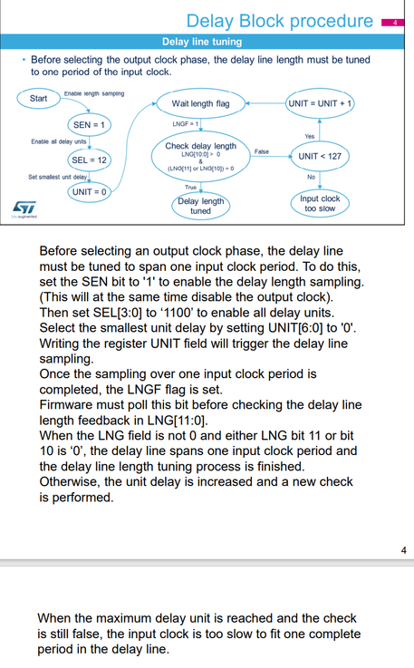

Please see this training for delay block procedure.
Note: The analog part of the delay block (the delay line) is PVT dependent, which requires the application to retune and recenter the output clock phase shifting if the STM32 VCORE voltage scaling or the environmental temperature change.

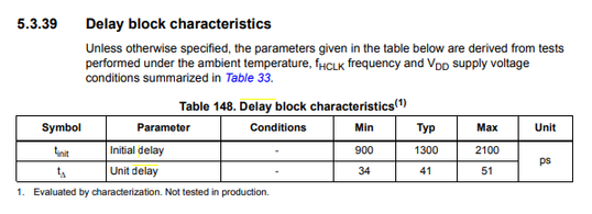

From the datasheet of STM32U5A9J-DK board, I have the following information:
  • Initial delay (tinit): Typical = 1300 ps (min = 900 ps, max = 2100 ps).
  • Unit delay: Typical = 41 ps (min = 34 ps, max = 51 ps).
Using the formula provided:
  • Unit delay = Initial delay + UNIT[6:0] × delay step.
  • Phase for output clock = Input clock + PhaseSel[3:0] × unit delay.
My calculation:
  1. Total delay needed: 2000 ps.
  2. Delay to achieve using UNITs = 2000 ps – Initial delay (1300 ps) = 700 ps.
  3. UNIT calculation: 700 ps ÷ 41 ps/unit ≈ 17.
Therefore, I have to set UNIT = 17
For fine-tuning, I plan to use PhaseSel for additional delay. Assuming the typical unit delay is 41 ps, setting PhaseSel = 1 or 2 could provide an additional 41-82 ps of delay if needed.

The parameters given in Table 148. Delay block characteristics are derived from tests performed under the ambient temperature, fHCLK frequency and VDD supply voltage conditions summarized in Table 33.
Also, it mentioned in the table three values min, typical and max.
I think, you can used this as initial values.
HAL_OSPI_DLYB_Cfg_Struct.Units = 17;
HAL_OSPI_DLYB_Cfg_Struct.PhaseSe = 1;
HAL_OSPI_DLYB_SetConfig(&hospi1, &HAL_OSPI_DLYB_Cfg_Struct);
