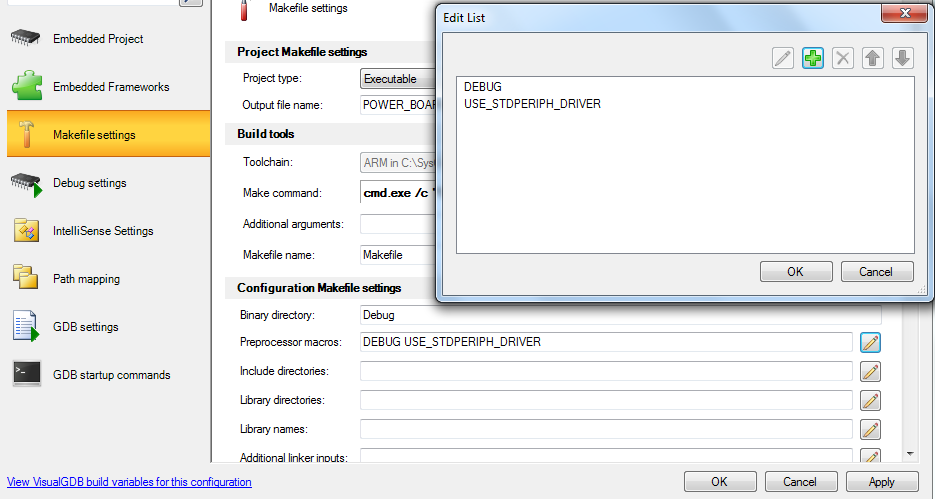

After this failure, which I did not know how to solve Itried to use some examples what I found here, like in [DEAD LINK /public/STe2ecommunities/mcu/Lists/STM32Discovery/Flat.aspx?RootFolder=/public/STe2ecommunities/mcu/Lists/STM32Discovery/UART%20example%20code%20for%20STM32F0&FolderCTID=0x01200200770978C69A1141439FE559EB459D75800084C20D8867EAD444A5987D47BE638E0F¤tviews=38320]this thread. Especially clive1 post at 6:42, but I have same problem as that guy with NVIC_InitTypeDef beingundefinied. I added preprocessor macro, butNVIC_InitTypeDef is still undefined.

NVIC_InitTypeDef being undefinied.
2016-02-16 12:48 PM
Suspect you need the right startup_stm32f0xx.s file, and the define for your CPU line.
Somehow I think you are mixing EXTI# with Cortex-Mx vector numbers.We’re moving the ST Community to a new platform to give you a better and more reliable community experience.
