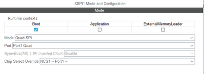

For example if you configure the XSPI1 mode Quad SPI (no multiplexed mode), then generate the code.
 You can see the XSPIM configuration in the generated code

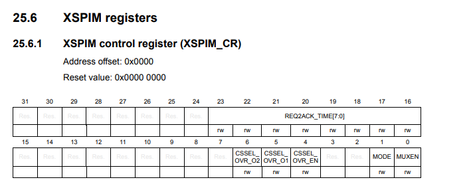

I think there is no EN bit in XSPIM_CR:
 You are absolutely right, there is no such register; I was negligent and meant the MUXEN.
