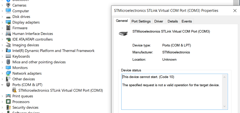

(After installing the virtual com port, cannot access)

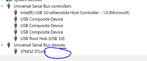

(Current visual with the recognized STM32 link Ukeil and other tools recognize)
I used to see com ports via the device manager in windows 10. I've installed the Link 009 drivers for stm32 boards and I get the original virtual port I'm used to in Windows 8 however it has an error code 10 that the device cannot be used. I've looked through 5 tutorials and nothing is helping. Windows 10 seems to eliminate the COM ports and there's no way to recognize the board through these so I can use a terminal debug window. I really need to printf debug items and I need to get the Com ports working again.

I followed the article and it didn't change anything.
