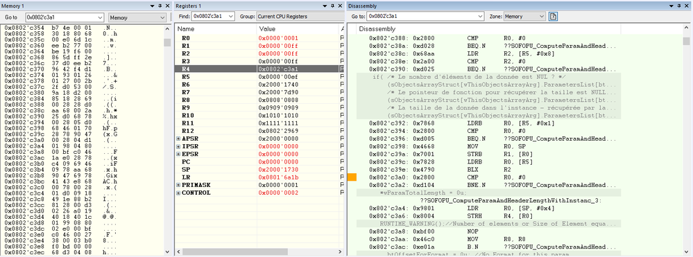

On the image below a R4 value is an unpair addresse for example

Ok, but what is R4 in this context?
Looks to be the address of code in FLASH.
Remember Cortex-M devices execute only 16-bit THUMB mode code, the code addresses will be ODD, as this flags it's 16-bit code, rather than EVEN which is 32-bit ARM code which it CAN'T execute.
