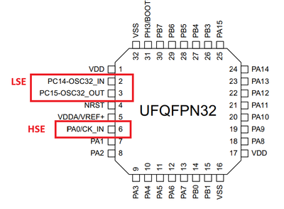

Checking The datasheet of STM32L432KCU6. It's a UFQFPN32 package.
LSE is using PC14 and PC15
HSE is using only PA0 and that case you need to use a crystal oscillator (XO)

2025-03-06 4:16 AM - edited 2025-03-06 4:45 AM

2025-03-06 9:53 AM
>>Does this controller support an HSE crystal?
As I recollect there is an STM32G0 or C0 which shares this form-factor, but supports an HSE bonded to the PC14/PC15 pins
PA0 / CK can take a TCXO, or other CMOS clock from another device.

2025-03-08 1:36 AM
@Nikunj_17 wrote:Please recommend a suitable crystal oscillator (XO) to connect to the PA0/CK_IN pin
In this role, it's just a straightforward digital input pin - like any other digital input pin - see the datasheet for the specifications.
2025-03-08 4:54 AM - edited 2025-03-08 4:56 AM
An exemple of a crystal oscillator with a power supply of 3.3V: https://www.farnell.com/datasheets/1998820.pdf
