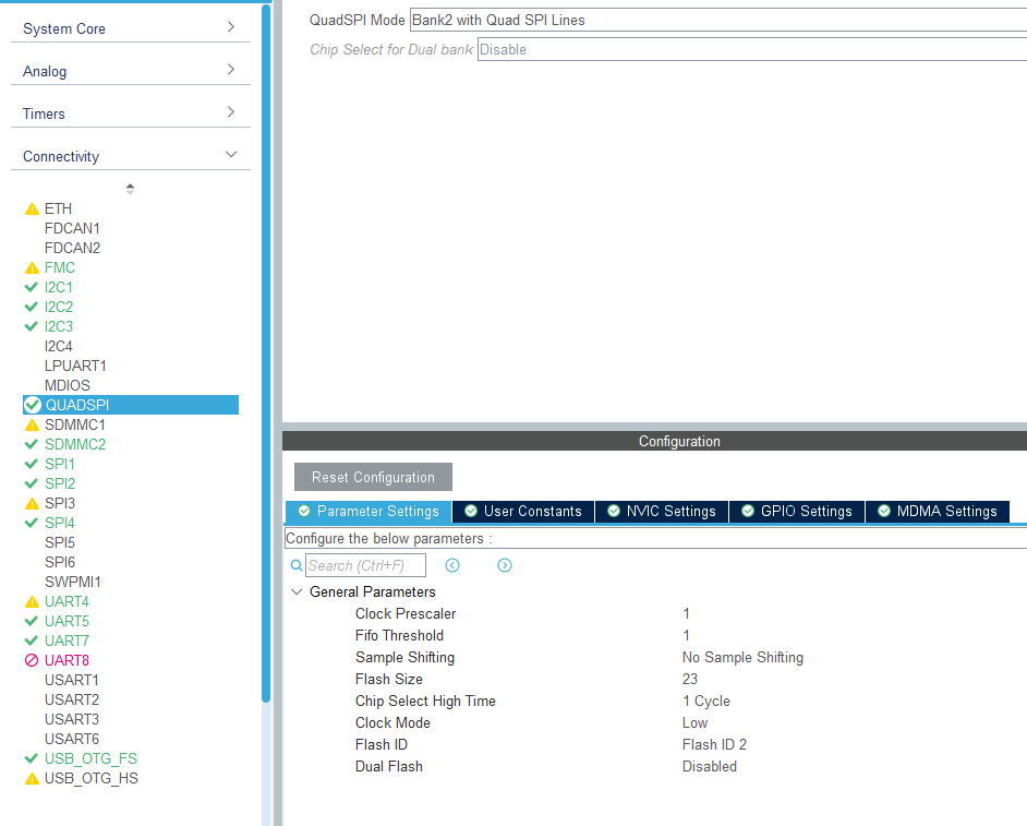

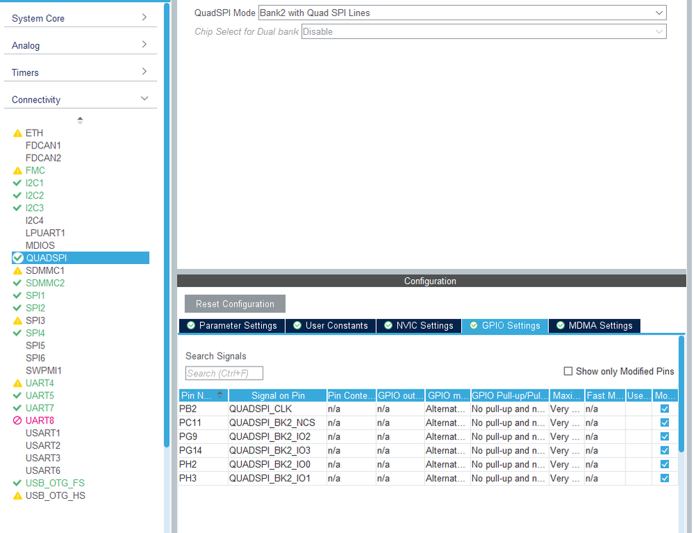

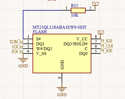

I have working project with MT25QL128ABA running at 120 Mhz on the same STM ( STM32H743) chip
It can run up to 133 Mhz
there is nothing called synchronous mode in the setup. you do not need this.
