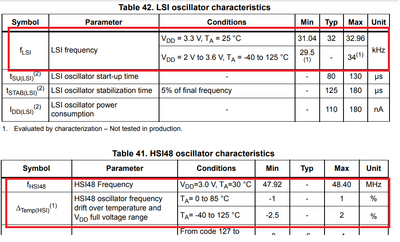

2024-03-17 8:07 PM
The table shows the frequency produced by the oscillators and its characteristics.
I want to measure accurate voltage given to ADC_IN1 pin. The measurement should be accurate and stable.
2024-03-18 12:21 AM
I thought you were referring to "sampling jitter" not the stability of the conversion. In that case you can refer to the AN2834 "How to optimize the ADC accuracy in the STM32 MCUs".
Check your VDDA/Vref+ power supply. The averaging samples is one of the technics to get more stable conversion.
