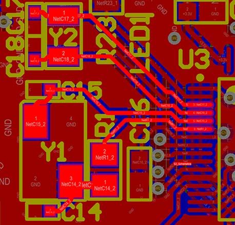

I have a
few questions
for
the design
and choice
of crystals
1. 32.768kHz. In datasheet is Recommended load capacitance max 15pF In AN2586 is ''To avoid exceeding the maximum value of CL1 and CL2 (15 pF) it is strongly recommended to use a resonator with a load capacitance CL ≤ 7 pF. Never use a resonator with a load capacitance of 12.5 pF'' In AN2867 is Recommended crystal resonators for LSE oscilátor EPSON FC135 Cl 6pF. Her is datasheethttp://www.ineltro.ch/upload/cms/user/FC-135_FC-255.pdf
Epson make only 7, 9 and 12.9pF. In my country isrealistically
available
only 12.5pF .I can
use it
or not
I
use it
a little bit
in it
lose
My PCB design,It is doing
something
wrong
or
it would
do something
better
Y2 is 32.768kHz Y1 is 8MHz2015-12-06 7:37 AM

only 12.5pF What does this mean? Which country? It's like saying you can only get micro-farad capacitors, when nano-farad ones are required/specified. It's not an area where a random substitution is going to work. Of all the parameters critical for the LSE not starting on the STM32F1 parts, being 9 or 12pF is top of the list. You'll need to find a different vendor/supplier of crystals, and pick a form-factor that is available.2015-12-06 8:59 AM
