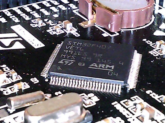

I've got a few of the Aliexpress Chinese STM32F407VET6 development boards that arrived recently. I became suspicious when the content of 0x1FFF7A22 is reported as 0xffff, when it should be the flash size in KB. The MCU chip itself reads:
STM32f407
VET6
991ES 9R
MYS 99 145 4
ST e3 ARM
04
Note that there's no revision number, which immediately made me suspicious. The MCU at first blush, seems to work okay, but what should I be aware of if I should try to use it?

Here's a photo of the MCU that shows 0xffff for the flash size. While it seems to work, I'm going to swap it out for one that reports flash correctly. I don't need another thing to worry about. What's notable on this one is how "ARM" is quite visible from a distance, but the rest of the chip labeling is a bit faded.
That's my problem--if the chips were "GD32F4" or "CKS32F4" labeled, at least I'd know what I was getting.
So, to answer my own question "Are there STM32F407 fakes out there?" The answer is clearly "Yes!"
