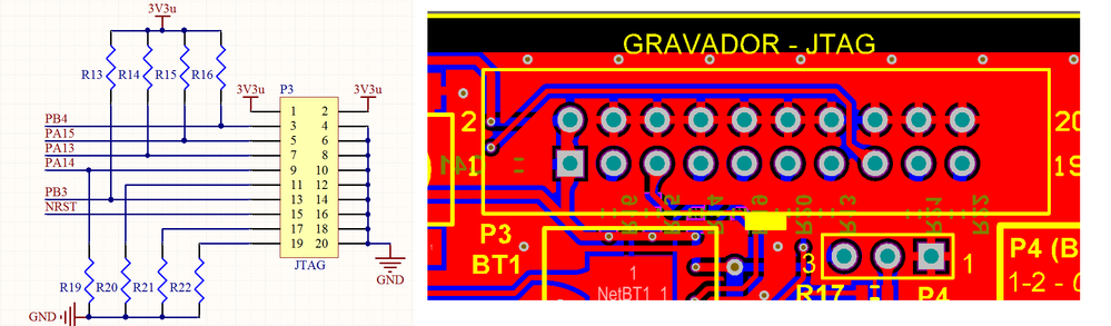

On your board check your programming header, make sure connectors aren't backward, or pins mirrored, or interleaved incorrectly (ie 1,2,3,4 vs 1,3,5,7). For SWD you minimally need the two SWD pins (SWCLK/SWDIO), GND and NRST, optionally the SWO(JTDO)

It seems ok to me the header and the pins.
The pins numbers are right with the datasheet.
Posted on June 07, 2013 at 18:55
That doesn't appear objectionable.
Bridged connections would be something to watch. Excessive heat might cause latent failure, but I'd discount this until I'd done some more general testing. Have a couple of boards built.
