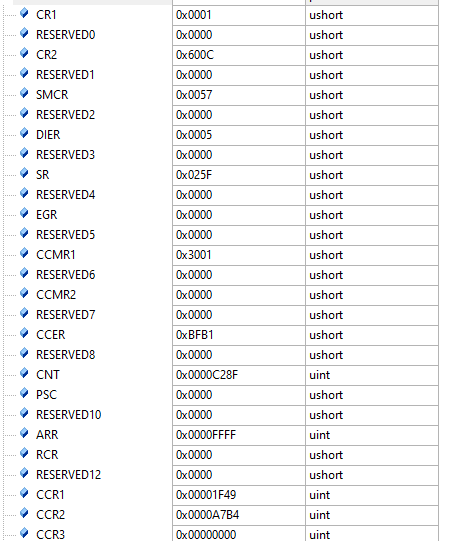

I try to generete interrupt when CNT register reach any value. But It generete when I enabled to interrupt EGR bit is always zero. when I try to change accept first bit not effected.
It is configuration
capture = TIM_GetCapture2(ExternalOSCTimer);
TIM_SetCompare2(ExternalOSCTimer, capture + .DelayOverFlow);
TIM_ITConfig(ExternalOSCTimer, TIM_IT_CC2, ENABLE);

I can't see any problem. From what I can see, compare interrupt fires correctly - see the SR register. EGR has nothing to do with it.
