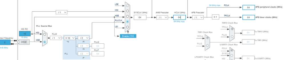

STM32CubeMX seems to show that 64MHz cannot be achieved with the internal high speed oscillator.
However, using an external 8MHz oscillator allows for 64MHz as shown attached.
Andy

Except that the data sheet does not allow you to interactively try different sources and see the results.
Getting clocks configured correctly is not easy for inexperienced users and the UI is easier for them to comprehend that the manuals in my opinion.
