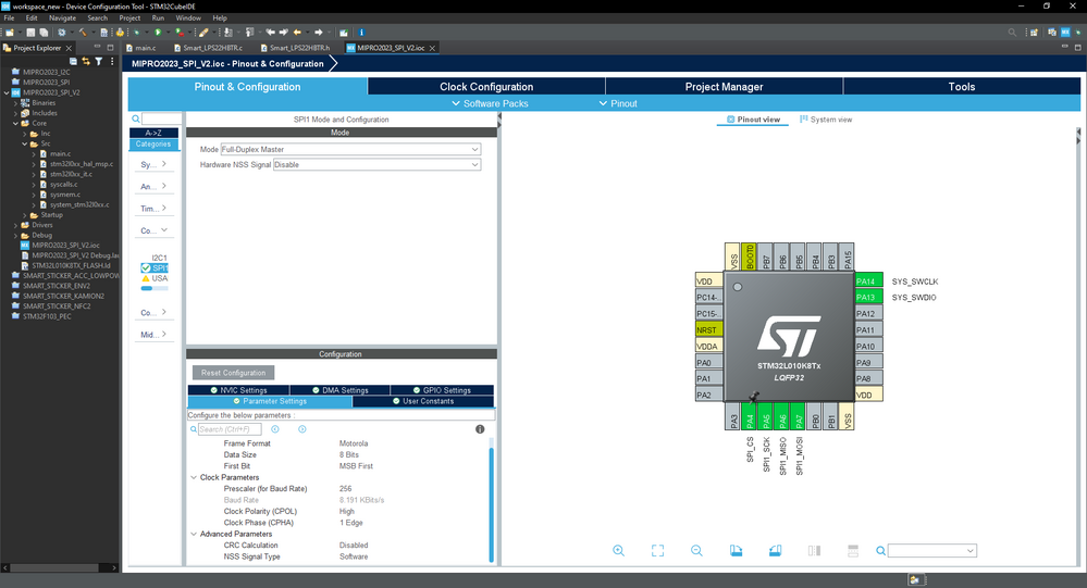

I have an LPS22HB sensor (https://eu.mouser.com/datasheet/2/389/lps22hb-1849683.pdf), and I want to connect it to STM32L010K8T6 MCU using SPI. The problem is, I get some temperature register readings with STM studio but they are invalid (0, 128, 255).
In settings, the MCU CS pin is a pull-up, while pins SCK, MISO, MOSI are no pull-up and no pull-down. All of them are in push-pull mode.
These are my SPI setting in the code:

1) As KnarfB pointed out, it should be like this => hspi1.Init.CLKPhase = SPI_PHASE_2EDGE;
2) When reading the register, I didn't send the R/W bit correctly (1 == read), so I failed to get good data
The code below is what works great for me. I appreciate your help KnarfB and S.Ma.

If I look at the data sheet, shoudn't it be hspi1.Init.CLKPhase = SPI_PHASE_2EDGE;
hth
KnarfB
