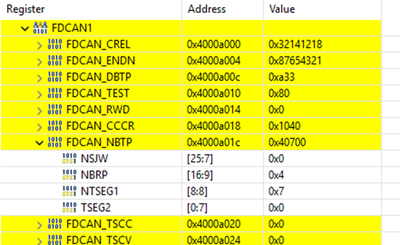

Therefore the corresponding registers are set as follows:
With:
this excerpt in the reference manual, the calculation is:
tfdcan_tq_ck = 0,02 µs <- (1/50MHz)
tq = 0,1µs <- (0,02 * 5)
The bit time ist 1µs <- (0,1 *( 7+1+0+1+1))
-> baudrate is 1 Mhz -> 1/1µs
But in the outgoing frames, I measure a bit time of approx. 3µs.
Enlarged:
How can that be? What did I do wrong or overlook?
Thank you and best regards,
HiST

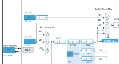

Just forget that you are using a nucleo-h755ZI-Q while in the Clock config you set the crystal to 25MHz in a crystal mode! But there is no external crystal in that board connected to OSC_IN/OSC_OUT.
This is the schematic:
What I suggest is to use the bypass mode but for that you need some steps:
1- Modify the STLINK MCO output to generate 5MHz instead of 8MH generated from HSI. Ensure SB72 is soldered. Please refer to this article to do that: How to use STLINK-V3 MCO output on Nucleo boards as a precise clock source for STM32
2- In your ioc file you need to update the RCC config: HSE in Bypass mode with HSE value = 5MHz
+ use the same bit timing config I provided in my previous post.

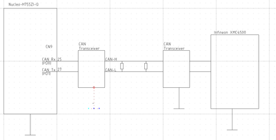

Attach your ioc file and tell more about what you are connecting to nucleo-h755ZI-Q as a second CAN node.
2025-09-29 2:28 AM
I don't think it is the correct method to measure the bit timing without establishing communication, there shall be at least one other node to acknowledge the message.

Hello STuser2,
There is another node that is not responding. The measurement should show at least one bit with the correct time.
I also have a logic analyzer that cannot interpret the signal from the FDCAN1.
Best regards,
HiST

According to your ioc file:
1- The FDCAN clock source is generated from an external crystal which is OK.
2- The bitrate is set at 1MHz which is correct.

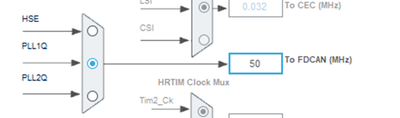

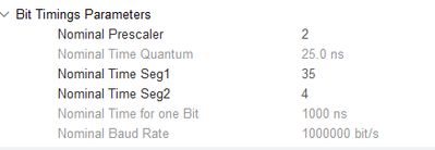

3- Better to increase the FDCAN clock and increase TSeg1/Tseg2 values with a sampling point positioned at ~87.5%. Therefore, I recommend the following config:
FDCAN clock source = PLL1Q = 80MHz:
and CAN bit time (sample point set at 87.5%):
2025-09-29 3:09 AM - edited 2025-09-29 4:04 AM

2025-09-29 4:01 AM
Hello m3ALLEm,
yes, thank you, this was the solution.
And also responsible for some other problems I had.
Now I also measure the correct bit time.
