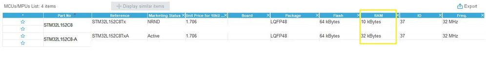

I read the datasheet, a = device generation a, but I don't know what the difference is. Can you explain it in detail?

I attached the Excel file detailing and comparing the characteristics of STM32L152C8Tx with STM32L152C8TxA.
The difference is on RAM:
  • STM32L152C8Tx = 10 KB
  • STM32L152C8TxA = 32 KB
0693W00000ANpsZQAT.jpgYou can use the ST-MCU-FINDER tool (integrated also in STM32CubeMX) which offers the features to compare the characteristics of two or more MCUs through the "Cross Selector" tab. I advise you to refer to the UM1718 in section "Cross selector" for more details.

Guess you'd want to look at the Reference Manual and DEV_ID, and then the Errata, which should indicate the types of things fixed in later steppings of the IC
Sorry,I don't know what you're talking about. You seem to offer a way, but that's not what I want to ask for.

waclawek.jan
Super User
There's also a migration document between the non-suffixed and -A-suffixed STM32L15x, TN1176.
