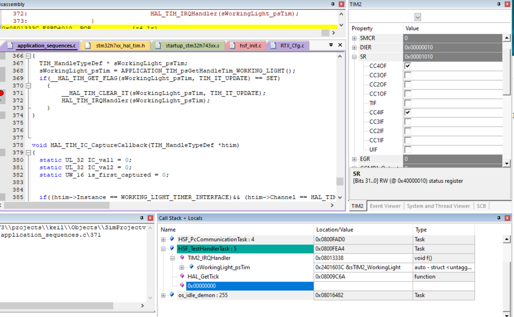

Hey, I didn't understand what you said? You mean to try with different frequencies?But this is the latest screenshot
2021-11-08 9:40 AM
But callback is not issue for me. Returning to main is the issue. The callback is working well. I was able to set breakpoint and check. But not going to main again.
