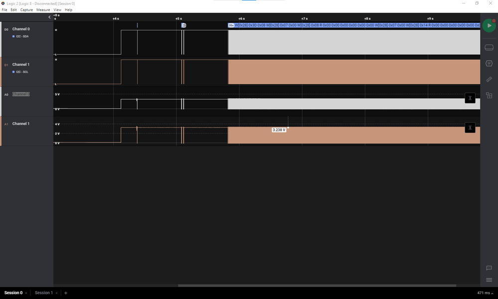

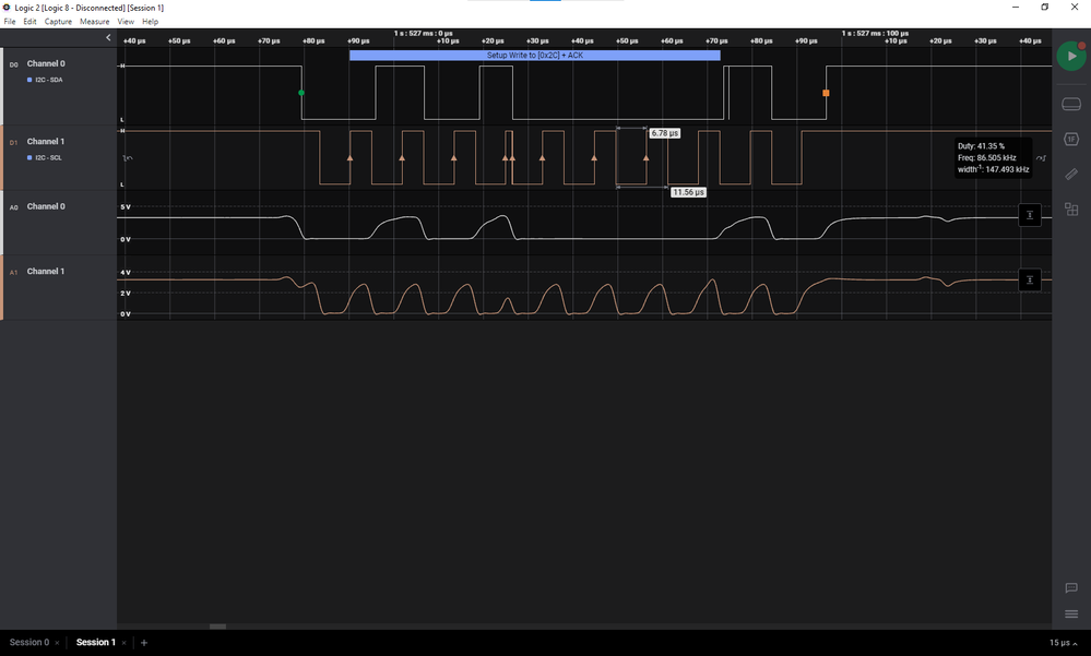

Okay, the logic analyzer definitely showed me something. It looks like I was right about something related to running both of them at once is causing the signal to get corrupted.
Here's what it looks like when run successfully:
And here's unsuccessfully:

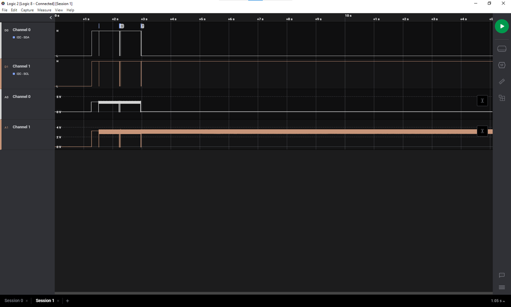

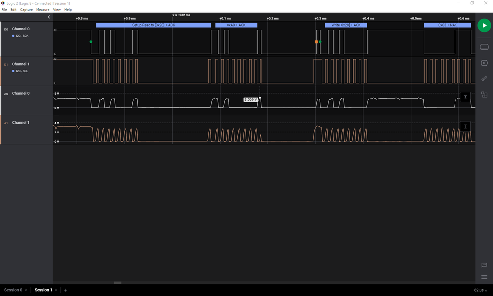

Additionally, I can confirm that the addresses are being messed up. Once again, successful example with the DRV placed in standby mode:
and unsuccessful with the DRV enabled, but providing a signal for no vibration:

STM is master from functional graph seems as you implement sw I2C not hw.
9-th ACK CLK is extremely delayed and analog signals seems your pull ups is weak.

This is all wired and on I2C. It doesn't look like the I2C signals going to the DRV2605L are getting in the way of the I2C signals going to the BNO; all the I2C commands that are used to initialize/configure the DR2605L for LRA PWM mode are sent before the ones used to initialize/configure the BNO055.
However, while the BNO055 is being configured, the DRV2605L will start running the LRA motor based on a PWM signal from the STM32L5 unit, and this is when the I2C signal heading to the BNO055 goes all wonky (see images 2 & 4).
