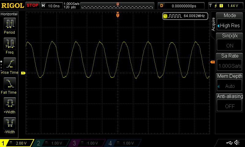

... and as your oscilloscope looks exactly like my Tektronix with only 100 MHz Bandwidth:
to check a 50 MHz square wave, you will need much higher bandwidth.
Not to forget the probe, and how it is connected to the test point - mind the GND connection, which should not run over a few inches of extra cable.

and probe is 10:1 ? how many Pf input ? min. 200 MHz type?
+ square wave is adjusted ?
64Mhz out on MCO1, with my DSO, and with 100MHz probe (so no square possible, just similar sine wave):
and 100Mhz , 4Vss ...
