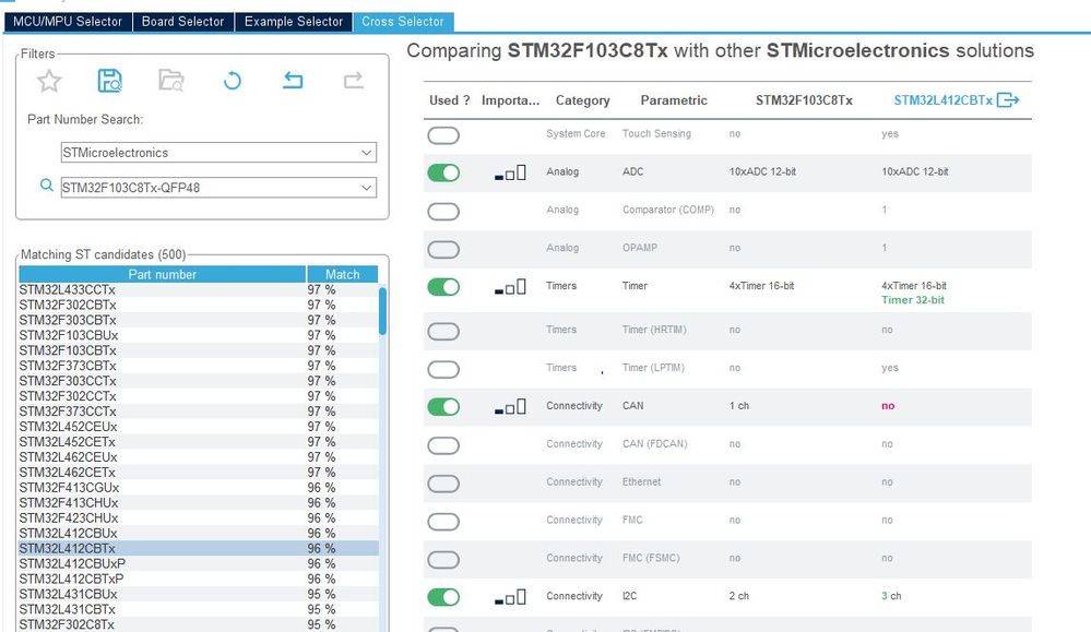

In addition of datasheet comparison, I advise you to use ST-MCU-FINDER integrates the Cross Selector feature (also integrated in STM32CubeMX tool) which allows you to compare the characteristics of two or more MCUs products, and to display the list of compatible MCUs.
I attached the Excel file comparing the characteristics of STM32F103C8Tx with STM32L412CBTx.
0693W000008yItQQAU.jpgImen
When your question is answered, please close this topic by clicking "Accept as Solution".

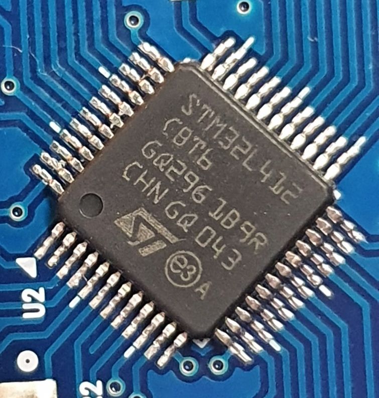

waclawek.jan
Super User
Isn't there 'P' suffix on the chip? Post photo.
Imen,
This is a recurring theme here... Can the DS be please updated with the 48-pin P-suffixed parts?
https://community.st.com/s/question/0D50X0000BFzzwvSQB/which-stm32l412-mcus-have-smps-and-are-in-production
Thanks,
Jan

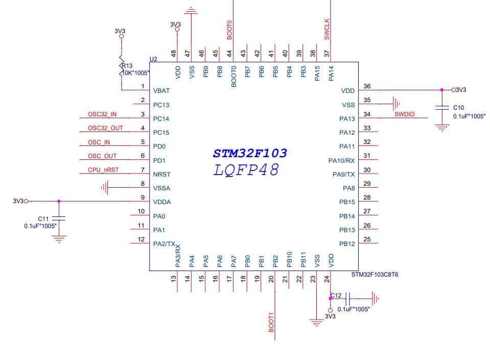

when i try programming with swd, it cant read device information. ( i checked swdio and swclk signal, it look like no response from STM32L412 )
after several swd connect try, mcu be broken. (voltage is 330mv)
this is recent one, it is not broken yet..

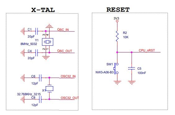

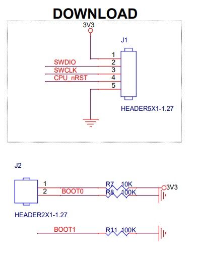

0693W000008yLfHQAU.jpg0693W000008yLrXQAU.jpg do i need to edit schematic for use this? (i know L412 has no BOOT1. it just low input gpio )
if i missed something, plz say that.

Did you check that pins like VDD, VDDA, VSS, nRST, OSC_xx are the same ?
Besides the SWD pins ?
AFAIK, it is recommended to buffer VDD with ceramic capacitors as well, electrolytic caps have a relatively low self-resonance.
