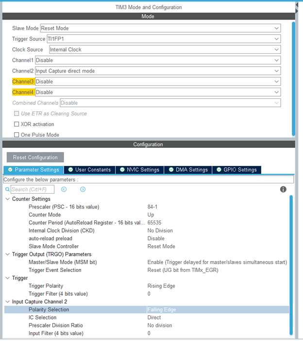

I am on STM32F401 and I want to measure PWM duty cycle (PWM input) with timer 3 and a DMA channel. I'd like to have the DMA to do several measurements and then calculate the average over it. My configuration is like this:

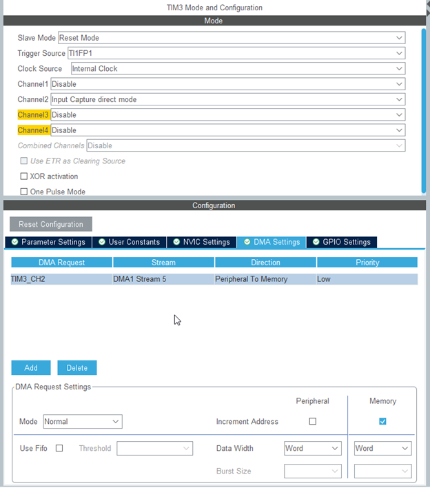

My DMA config is like this:

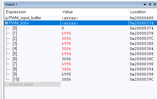

When I put a breakpoint in that routine I see this in the watch window:
To the timer 3 channel 2 I have connected a 100Hz PWM signal with 30% duty cycle as a test signal. I use a clock of 84MHz and have set the clock divider to 84-1 so that one tick is 1us. In the watch window the signal is reflected by the ~7000 (low time) and ~3000 (high time) counts, this is because I've set the polarity selection to 'both edges'.
I am interested in the high time only (duty cycle %) but if I set polarity selection to Falling edge I get only numbers around 10000 which is the full period (100Hz) and I don't understand this. I would expect numbers around 3000 (high time of the signal).
I expect the trigger to start the measurement but obviously it does not work like that. Can anyone explain how it works and if it is possible at all to measure only duty cycle in this way? (i.e. which changes are needed)

If you capture only one of the edges, the interval will be always equal to the PWM period, no matter which edge you choose.
The timer has a special PWM measurement mode - maybe that's what you need - check the Reference Manual. I don't think the DMA is needed for this task.

Yes, I just wanted to investigate if this is a possibility which can be used. If the DMA controller can do several measurements it can save a lot if IRQ's/context switching on the CPU. When the value is needed, let's say every 100ms (application cycle) one can simply calculate the average over the samples as provided by the DMA controller. I think that would be very neat.
