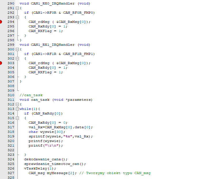

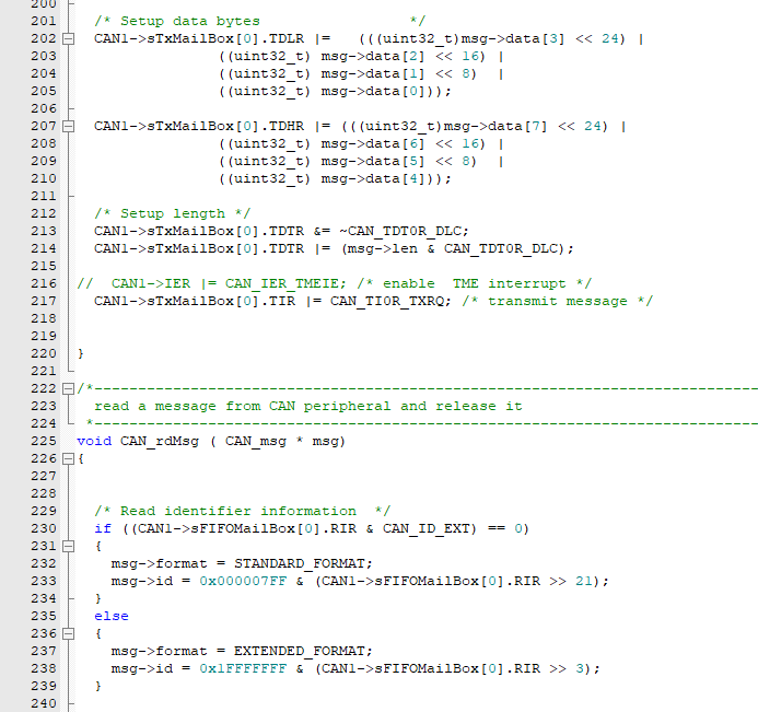

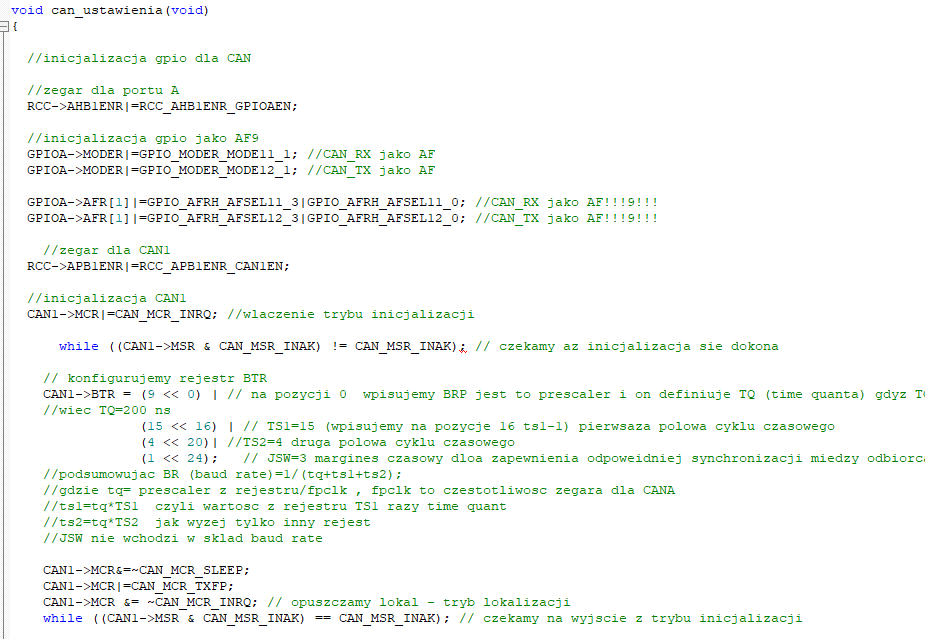

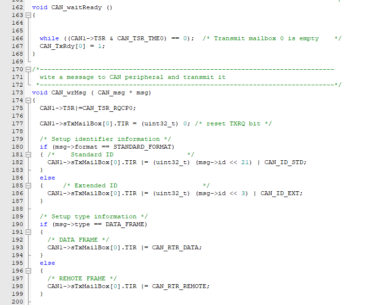

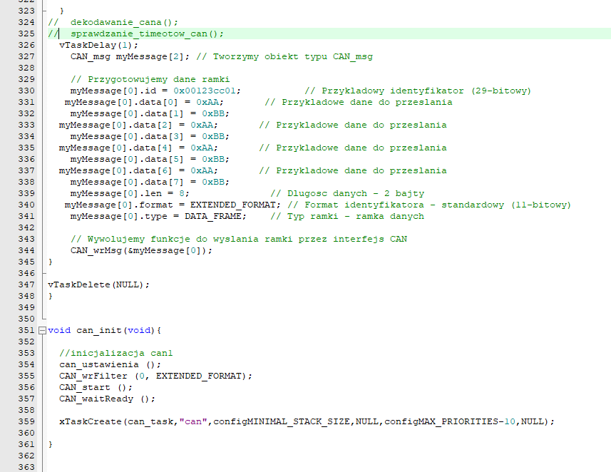

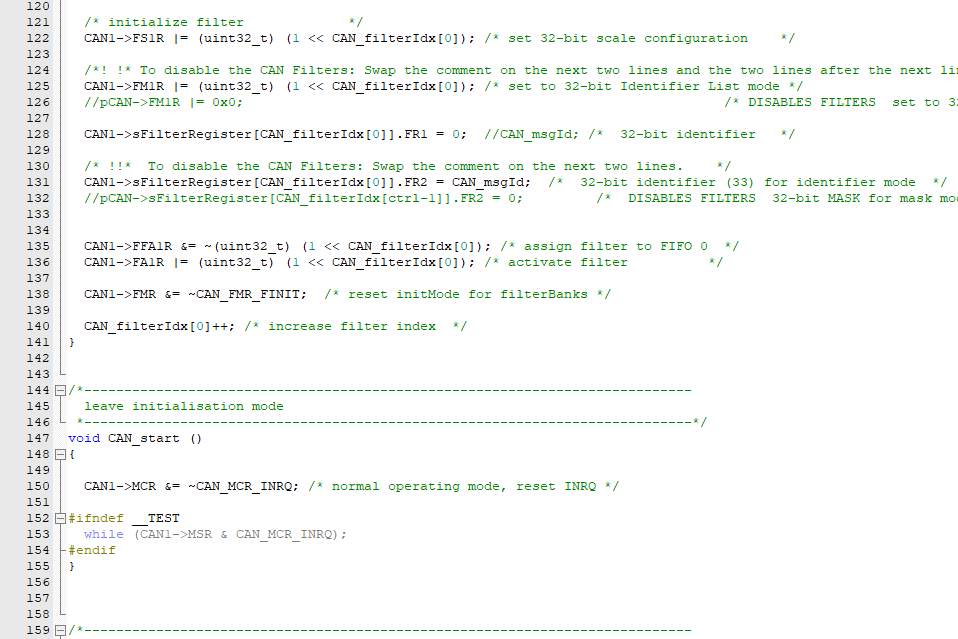

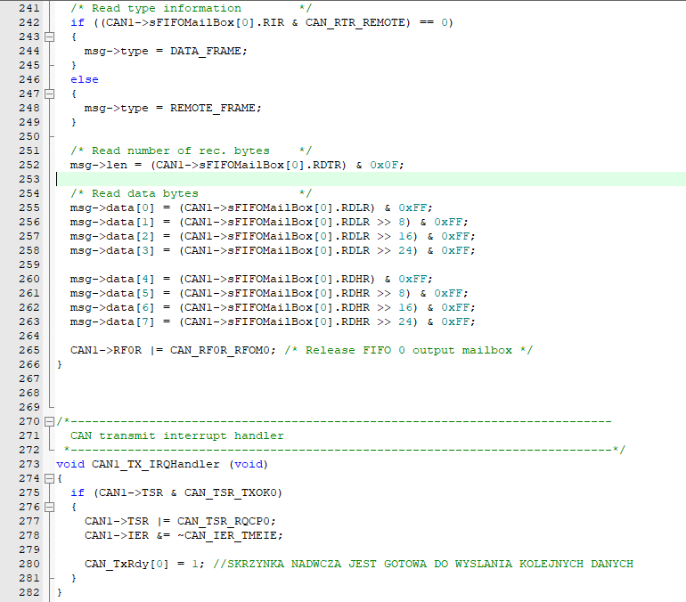

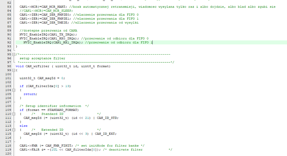

Hello, I initialized CAN on STM32F429ZIT6 on registers. I would like to tranmitt and receive messages. But on transmission lines is silence. In my opinion I forgot about any register, but I don't know which. So could you help me what i sholud change in my code?
