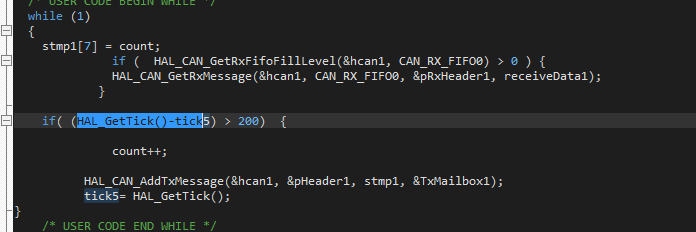

When I try to transmit can CAN data it doesn't work inside the time-delay condition... but it works properly without that condition...
Does anyone knows what's the issue?

Do you initialize the tick5 value at loop entry?
Is this in a callback?
Does the tick count advance here?
2023-01-24 6:30 AM
I have initialized it as a global variable
No, its in the main while loop
I'm new to stm32, don't know what your question is....
I just want to send data using CAN BUS at every 200-300ms. But when I try to transmit it in if(HAL_Getick() - tick5 > 200) it doesn't work....

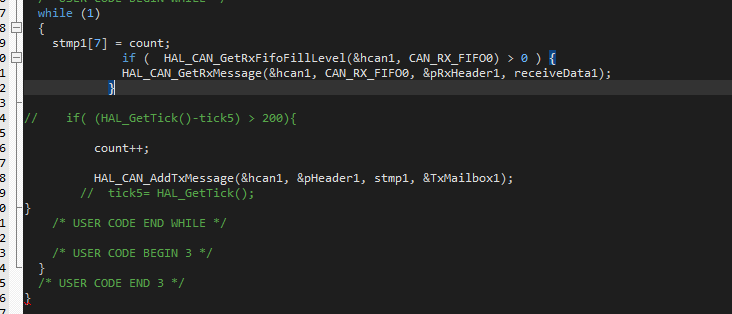

show us

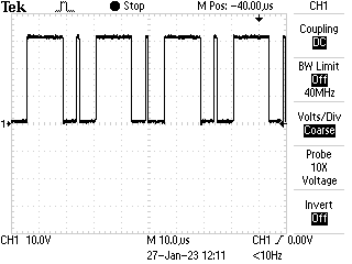

it return success code, but when I checked on oscilloscope, there is no signal...
