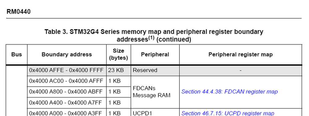

STM32G4, RM0440 Rev 7, page 85
The FDCANs Message RAM addresses, for example FDCAN1 “0x4000 A400 - 0x4000 A7FF�? are incorrect, there are no 1 KB sections, it should be 0x0350 B.
Also the FDCANs Message RAM area in the table is not related to the FDCAN register map

2023-03-30 6:33 AM
Hi @AVasi.11 ,
The first issue is already reported here.
The correct values of FDCAN addresses ranges are:
• FDCAN1:
– start address 0x0000
– end address 0x0350 - 4=0x34C (as in Figure 669)
• FDCAN2:
– start address 0x034C (FDCAN1 end address) + 4 = 0x0350
– end address = 0x0350 (FDCAN2 start address) + 0x0350 - 4 = 0x069С
This issue reported internally.
Internal ticket number 123624 is submitted (This is an internal tracking number and is not accessible or usable by customers).
Thanks
