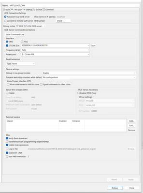

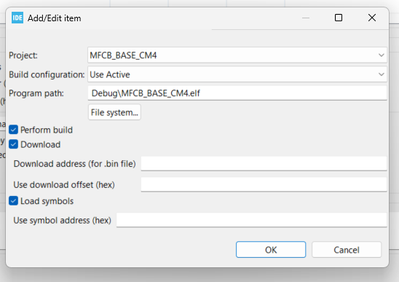

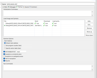

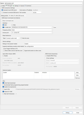

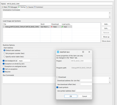

Hey,
Thanks for the information.
I have already followed the documents and the video, but unfortunately without success.
However, there are some differences between the video and the documentation, as well as discrepancies between the documentation and what can actually be seen in the software.
The development board can be programmed without any issues.
I also used it to test the overall concept and flow of the code itself.
However, when I try to program a blank STM32H757 using the same settings, things go wrong.
The MCU does not get programmed, and afterward, it’s no longer accessible via ST-Link.
Following either the video or the documentation leads to the same result.
Attached are some screenshots showing my current configuration.
Best regards,
