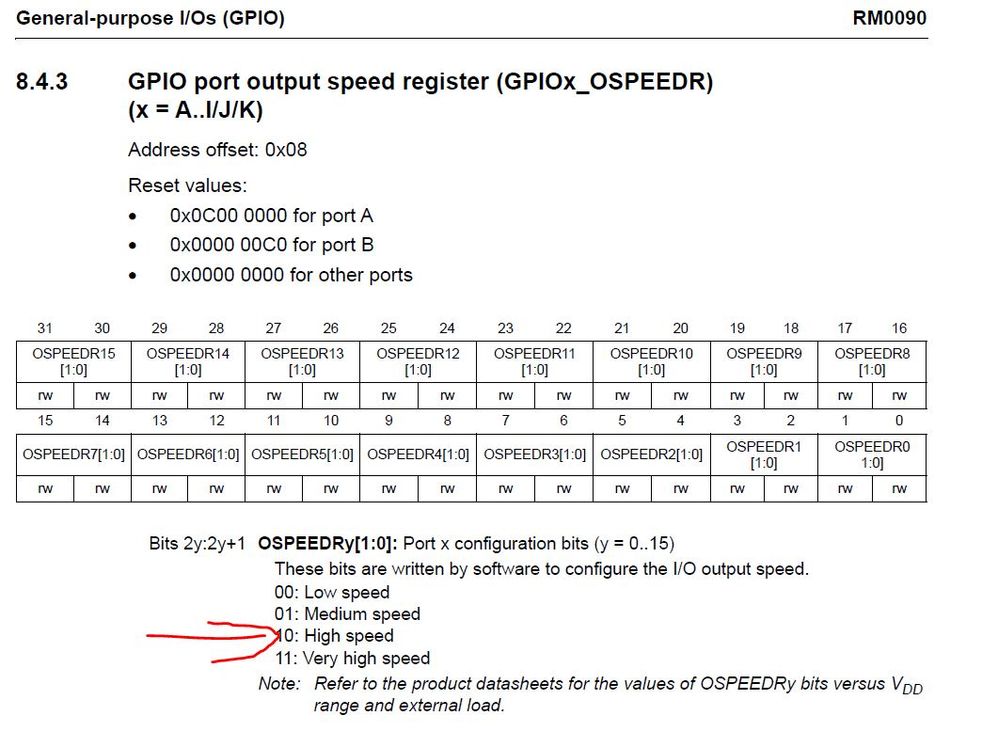

The OSPEEDR is set to be fast.

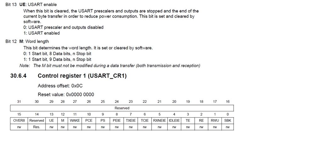

USART2->CR1|=(1<<13);
USART2->CR1&=~(1UL<<12);
By the USART2 CR1 register bit 12 the data packet is 8 bit long.

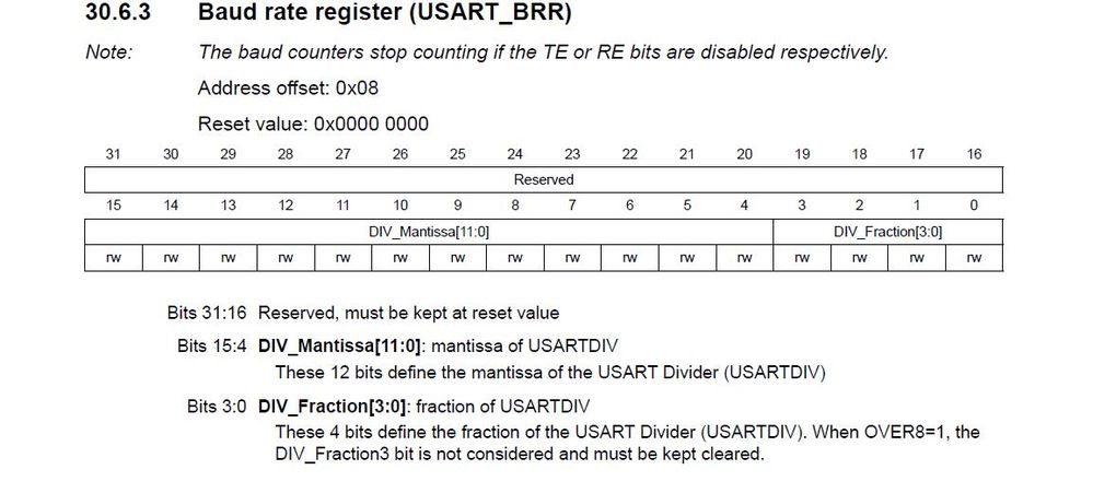

USART2->BRR=(7<<0)|(24<<4);
The most critical thing is BRR i put 7 in location 0 and 24 at location 4 as shown in the printscreen bellow.

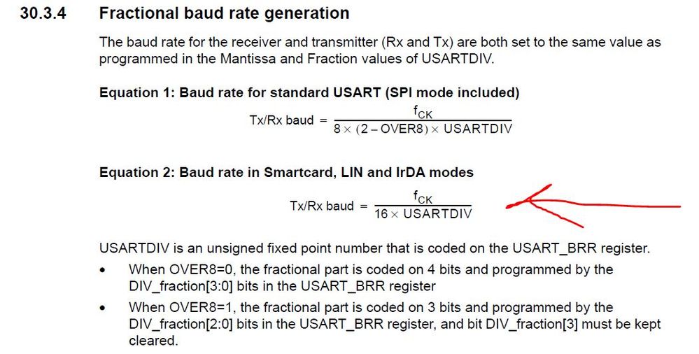

My USART CLK is 45MHz which is divided by 16*24.7
45000000/(16*24.7)=113866

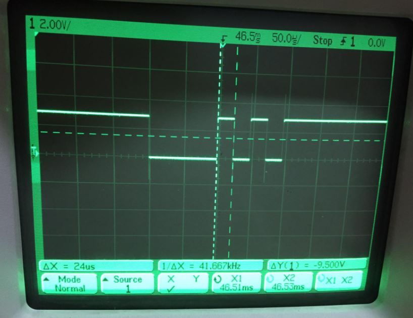

In reality i get the following Scope waveform which is not the calculated frequency.
the distance of a single bit as you can see between the cursors is 2.4uS
Where did i get wrong why i got such low frequency?

Which STM32?
Check the APB speed e.g. by running PWM on a timer on the same bus. Read out and check/post the relevant RCC and USART registers content.

Check HSE_VALUE define and PLL settings.
Set up a TIM to toggle a pin, toggle a pin in SysTick interrupt, or export internal clock via MCO PA8 pin.
SPEEDR setting controls slew rate of pin, ie how aggressively it is driven and by how many transistors.
