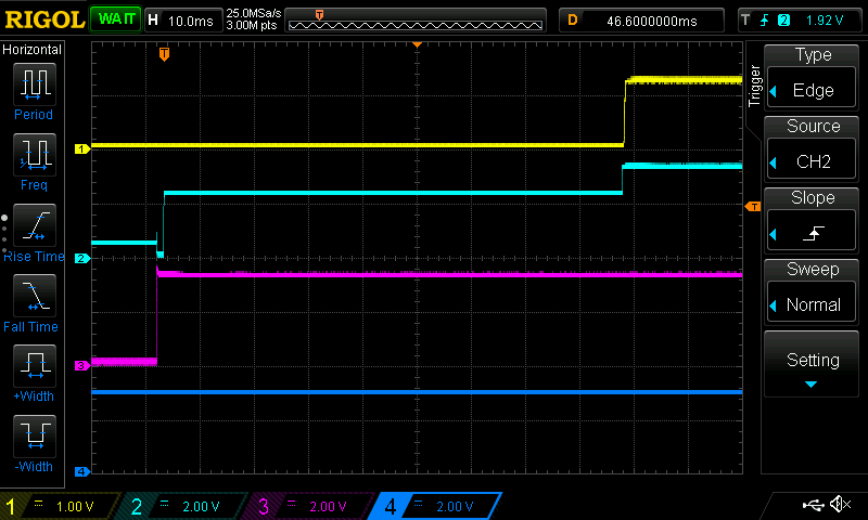

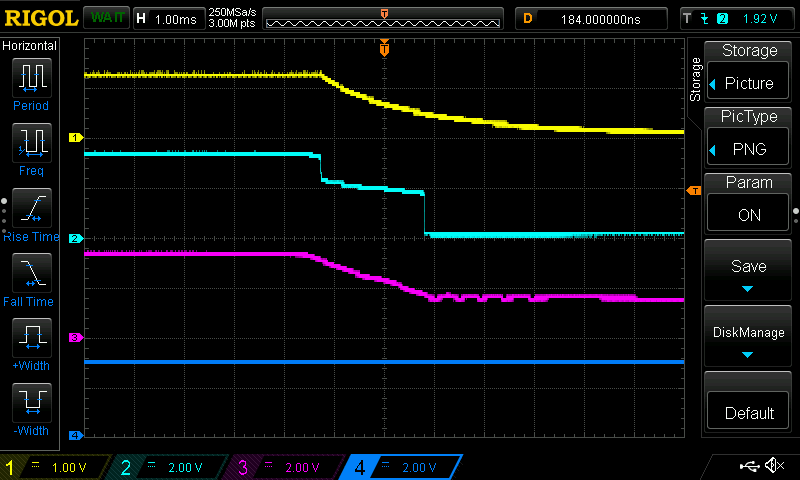

2017-03-01 12:05 AM
Here are the startup and shutdown sequence.
Ch1-Yellow: 1.2V connected to Vcap_1 and
Vcap_2
Ch2-Cyan: NRST (PA0)
Ch3-Purple: 3.3V connected to Vdd.
Ch4-Blue: VBAT
Startup (100ms recording)
Shutdown (10ms
recording
)2017-03-01 3:23 AM
Then this is the problem.
You MUST hold both reset and PA0 low long enough until V12 and VDD gets stable, and you must pull them low soon enough when they start to fall.
See the Startup in regulator OFF mode: fast V DD slope- power-down reset risen before V CAP_1 /V CAP_2 stabilization figure in DS.
