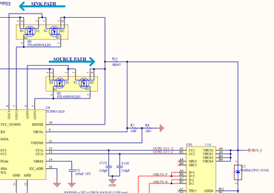

I went to investigate a bit, and even just putting oscilloscope probe on that resistor (R13) used for Isense (which is on this board 47 mOhm) causes over-current detection thus I think the actual problem is that on this board there is no external capacitor on the VBUS line.

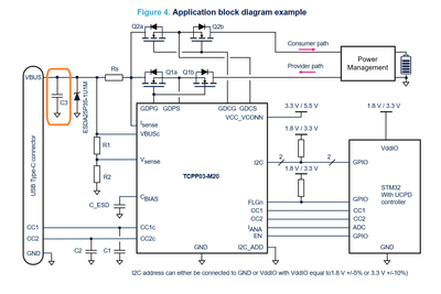

In the datasheet of the TCPP03-M20 the block diagram below shows C3 for which datasheet says 100 nF, 50 V :
But on the B-U585I-IOT02A board according to schematic, there is no capacitor, see below:
Anyways, my conclusion is that without hardware changes on this board there is no way to avoid this over-current event when connecting any USB Device.
I don't think USB memory sticks I have are a problem.
I will just do what I already did (basically your workaround 1.) after detecting OCP send the recovery word, which is all supported by BSP driver already.
