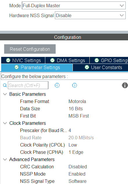

[UDP RC] rv= -1\r\n-1\r\nERROR: Unknown Error\r\nUsage: S3 <0001 - 1460>and this is SPI setting of the microcontroller:
