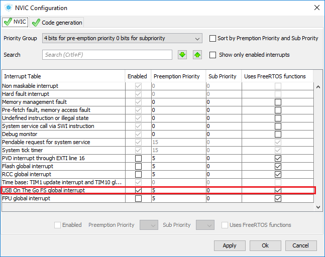

Itcouldbe clock related, or maybe you are missing the USB interrupts being enabled (check in CubeMX).
I take it you mean this?

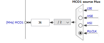

Maybe see if you can output the 48 MHz USB clock on the MCO pin to verify... can't remember off the top of my head if you can actually do that.
It doesn't look like I can do that. It looks like the closest I can get is 36 MHz:

I think I see your problem, you have USB_OTG_FS set to act as a host rather than device.
In CubeMX on pinout tab, locate USB_OTG_FS and set mode to device only, also untick Activate_VBUS... don't think this is required, check the 429 project. Then if you look at the top under middlewares USB_DEVICE should be in bold, click the drop down box (Class for FS IP) and select communication device class. Save and generate code.
You should get some functions, in defaultTask (or main.c, can't remember), that initialise the USB.
That should be enough to get the board recognised by the PC, assuming you have no other issues in your application code.
