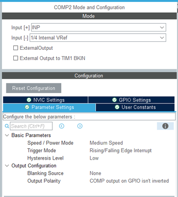

I am working with an STM32G071. I am using Comp2. I have configured it with the STM32CubeIDE. Presently, It is set to "medium" speed/power, and Rising Edge Input with High Hysteresis. The positive input is set to INP/PB6. The negative input is set to Internal VRef. (I can't find anywhere in the manual what that value is. Maybe its only in the data sheet!?) Anyway, my problem is when I enable the AC it instantly triggers the interrupt. However, I don't see any evidence that VALUE is ever high. Meaning It doesn't look like the comparator is actually triggered but maybe its some type of configuration initialization issue? If I ignore this first trigger the AC seems to work fine afterwards.

Stm32cubeIde produces the following relevant source
static void MX_COMP2_Init(void)
/* USER CODE BEGIN COMP2_Init 0 */
/* USER CODE END COMP2_Init 0 */
/* USER CODE BEGIN COMP2_Init 1 */
/* USER CODE END COMP2_Init 1 */
hcomp2.Instance = COMP2;
hcomp2.Init.InputPlus = COMP_INPUT_PLUS_IO2;
hcomp2.Init.InputMinus = COMP_INPUT_MINUS_1_4VREFINT;
hcomp2.Init.OutputPol = COMP_OUTPUTPOL_NONINVERTED;
hcomp2.Init.WindowOutput = COMP_WINDOWOUTPUT_EACH_COMP;
hcomp2.Init.Hysteresis = COMP_HYSTERESIS_HIGH;
hcomp2.Init.BlankingSrce = COMP_BLANKINGSRC_NONE;
hcomp2.Init.Mode = COMP_POWERMODE_MEDIUMSPEED;
hcomp2.Init.WindowMode = COMP_WINDOWMODE_DISABLE;
hcomp2.Init.TriggerMode = COMP_TRIGGERMODE_IT_RISING;
if (HAL_COMP_Init(&hcomp2) != HAL_OK)
Error_Handler();
/* USER CODE BEGIN COMP2_Init 2 */
/* USER CODE END COMP2_Init 2 */

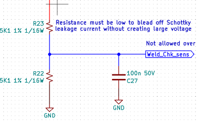

The Weld_Chk_sens is connected to MCU pin PB6. No other MCU functions are connected to PB6. The circuit shown is always at 0V when the COMP is activated and the interrupt is triggered.

I have also used
hcomp2.Init.InputMinus = COMP_INPUT_MINUS_3_4VREFINT;
As well as using DAC1 output as the COMP negative input. Still same behavior. Initial false trigger then normal operation.
